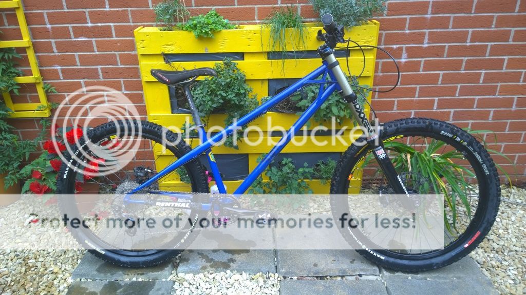

Just for you a very rare photo of the front wheel fitted (I normally store it with the wheels off and only fit them when I'm out riding)
And for minty freshness my herb garden is in the back ground.

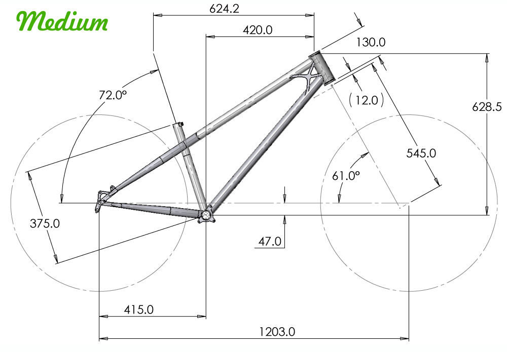

It has a 61 degree head tube and a 72 degree seat tube
Wow, that is quite modern! A riding buddy here builds a similar geometry bike and I am very curious how that feels on the trail. I'
m used to 73 (seat tube) /71 (steerer tube) degree frames.
Looks cool that does! Thanks for the pic with the front wheel :)
Just out of interest, (I'm not doubting it's strength or ability here) but will it be ok with those big triple clamps? When I was younger a few of my mates ripped off head tubes off their hard tails due to running similar fork as it caused extra stress round the head tube being such a stiff fork compared to the frame - I was always told it was a 'no go' but then I am a bit out of touch with some of the more modern downhill set ups - looks lovely though, great choice of components/colour scheme :-)
