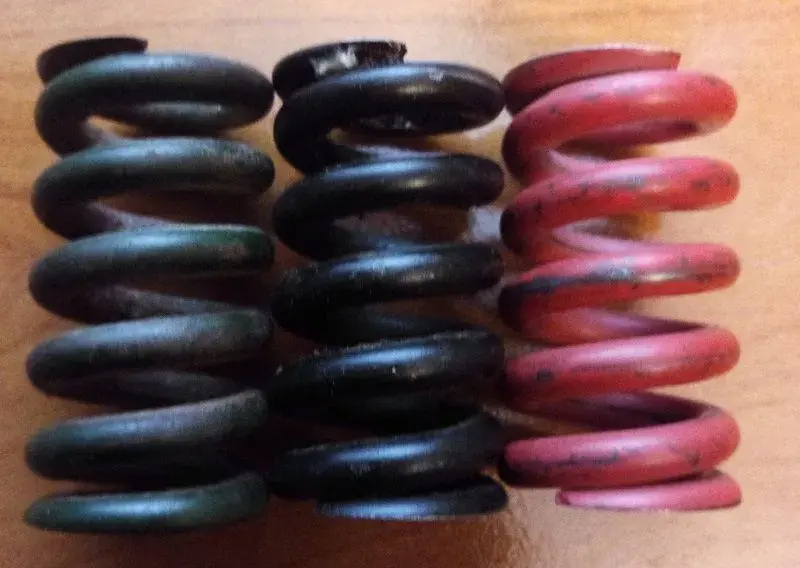

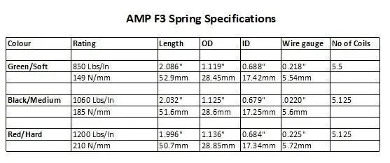

OK..here is the info which I have collated on the three different springs for the AMP F3 fork.
All with flat ground ends, and presumably all nominally 2" long.
They appear to have been specially made for AMP, not any standard die springs, US or metric. :roll:
ID could be slightly less for a replacement spring, but needs to be at least 16.5mm ID to fit the top hat for the preload adjuster.
OD is limited to 29mm by the machining on the lower linkage where the spring is seated.
All the best,

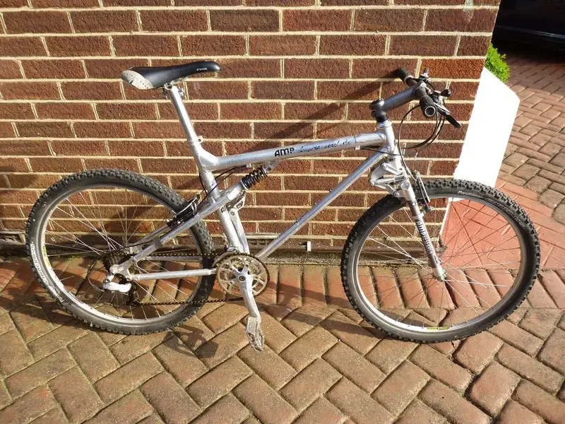

That was a good read, & very helpful! Looks like mine's a 1994 B3 then? Looking forward to this build.

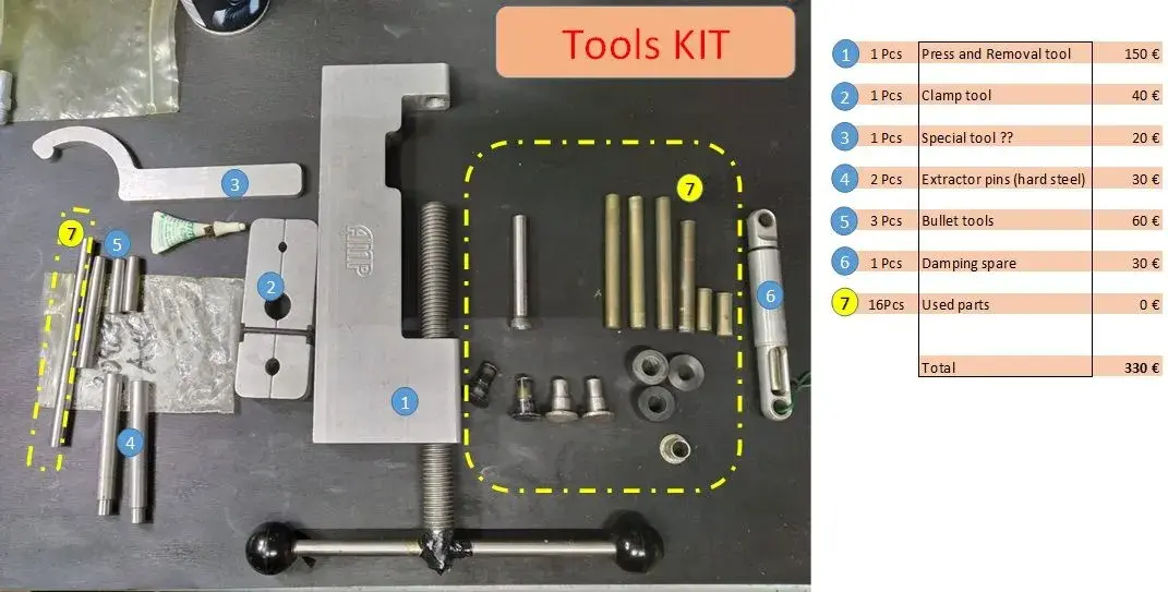

I've been dying to ask but which one of you lucky buggers managed to score this lot from Colnagoibex a couple of weeks ago? I checked in after work and by that time they'd already sold :x

Re: Re:
Bugger....not me. Didn't see it. There was a set on ebay at £400 which went last week too. :facepalm:
