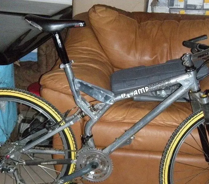

On the seat masts, the AMP spec dimension is normal BB centre to seat tube top, so not much help with the mast length itself.
I measured from the rear mounting bolt to the seat tube top on mine (Measurement E)...2 different dimensions from 3 smallish examples: 300mm and 287mm.
There is a distinctly longer mast around, probably 350mm ish:
AFAIK the B5 masts are the same as the B4 masts.
