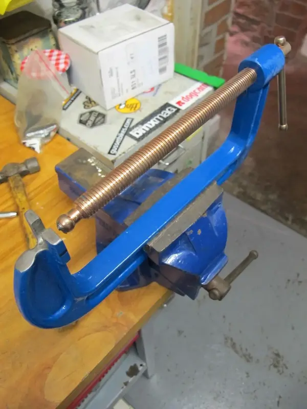

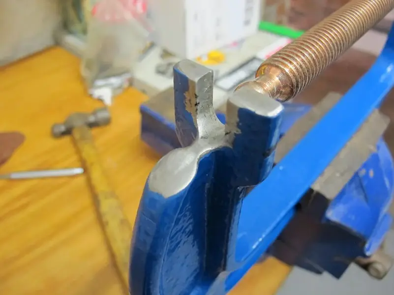

I've been drilling, cutting, grinding and filing over the holidays :xmas-wink: . It's still "work in progress" but I got impatient and had a go with it as is. Managed to push two pins out without too much of a problem but the pin in upper swing arm in the F4 is going to need some extra force.
Thinking of drilling out the tip of adjusting screw (now a ball) and making some pin specific inserts as there are two diameters used on the F4 i.e. it'll end up looking like an overgrown chain pin extractor. Also the adjusting screw is very wobbly so it's difficult to keep it accurately aimed at the jaw, so maybe some bracing is needed.

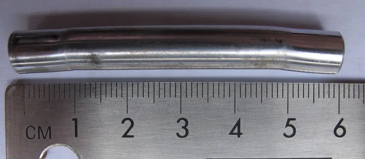

Bugger, no wonder it didn't want to come out... It looks like a banana! Where the hell am I going to get a 20 year old replacement? I would have asked Rampage to make me one but he seems to have disappeared off the face of the earth :( .
Any engineering company will happily do it. And as theres not much to it other than this- but straight, I wouldnt see them asking much. More like a lunchtime project for beer money.
