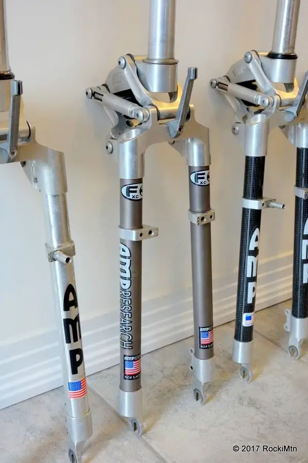

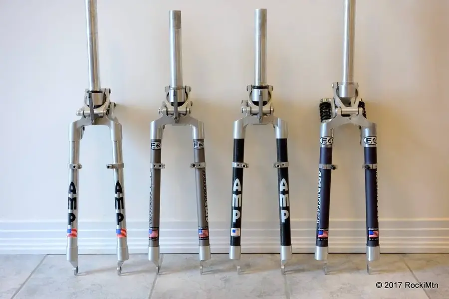

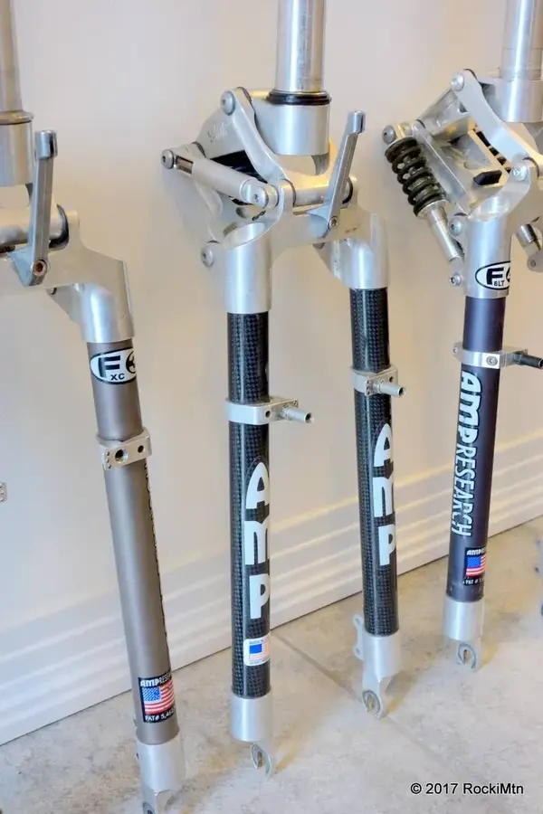

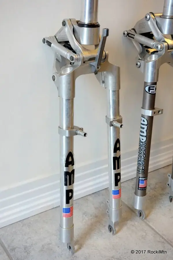

i share with you my current collection of spare forks! i also have two F2 forks in use on bikes, and F4 BLT on another. 8) i did have an F1 steel leg as well, but recently sold it to a friend in need.
left to right: F2, F3 XC, F3 XC carbon, F4 BLT
