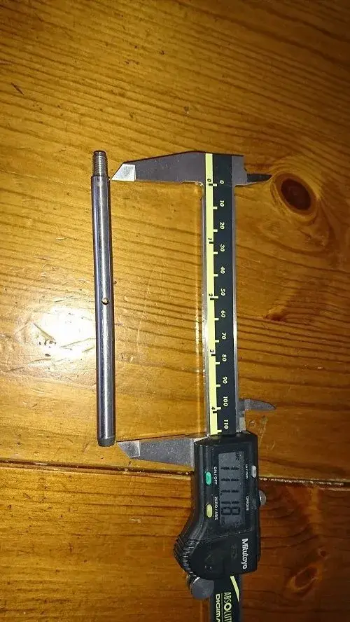

I am in the process of sorting out spares for AMP's and I do have most bits in my personal stash which I am using for the drawings for parts.
This is I believe a replacement stainless shaft for the rear shock, early ones were chrome plated alloy ones which once the coating is damaged wears easily.

Is that really a pic of a shock shaft? Might actually have one in a box actually, thought it was a tool to remove the pivots from the older forks with the c-clips?
Yep, it's missing the piston but that's on the old one and just needs swapping over.

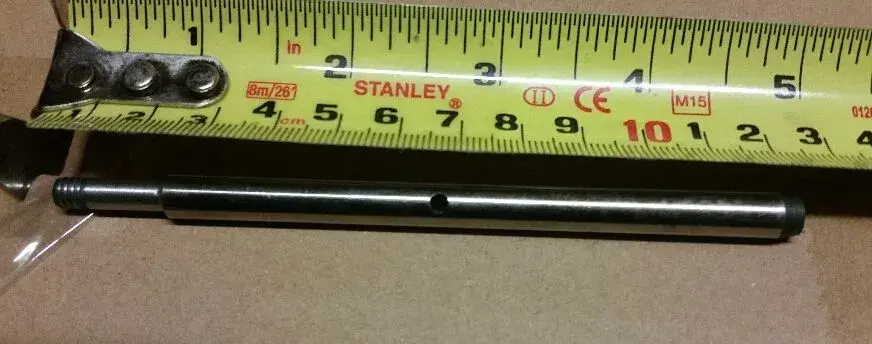

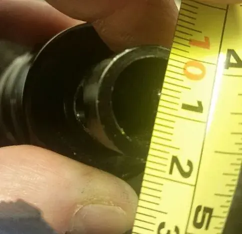

i might be interrested in the Risse shock; HOWEVER i know a guy who imported a B2 Risse Shock for his Mongoose, assuming it would also fit his other frame, which ist an original Amp Research B2. He was quite pissed that the two frames had different shock-slot diameters! Both frames had the double dontube so he naturaly assumed they are same generation with identical geometry.
It would be great if you could measure the diameter of the Risse "rod" which goes into the frame at the lower end! If its 19 mm I'm interrested!
I'll measure it, but fairly confident it will fit. Some of the shocks were designed for use with a sleeve to allow them to be compatible with more frames and I guess cost Risse less to make.
Length is also a factor as I believe this changed over time. I'll send some measurements and pics later today.
Here you go. Looks to be 19mm. Length is 145mm from end to centre of eyelet, and 155mm end to end.
