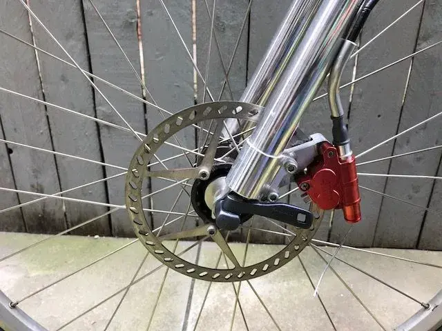

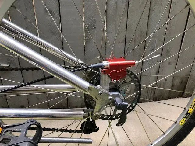

Alternatively, are there options for these AMP frames/forks to convert to modern IS mount calipers?
Thanks!!
I don't think you need to be a machinist...you just need to give the drawing to one....will not be much to make up. Colin Furze would be up for it.

Just saw the middle pic showing the guy made it from a cassette cog. brilliant. I need a rear too!
at any rate, i'm in NYC with no garage space or metal working tools. I'm really after someone else who's already done the troubleshooting and has either the brackets made and for sale OR a design I could buy and get to a machinist to fab up.
Thanks for the help
There definitely are machine shops on the East Side or def in Brooklyn who could do this for not-very-much.....the dimensions for the bracket are same front and rear and the drawing already sent has the exact dimensions....
I don’t see a drawing in the links...did I miss it? Only see the link to the manual and the link to that guys conversion in ‘09
