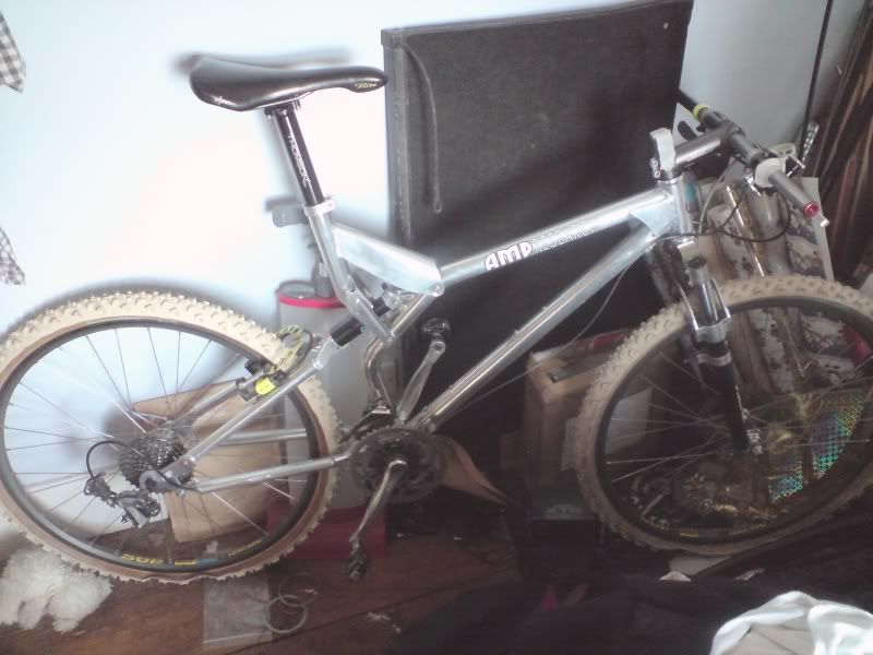

I have one in its mock build stage in the 'emergency man cave'.
Sorry the picture is poor (it's on my phone), but detail build will follow when I'm happy with the projects components.
If you get a chance - buy one!
