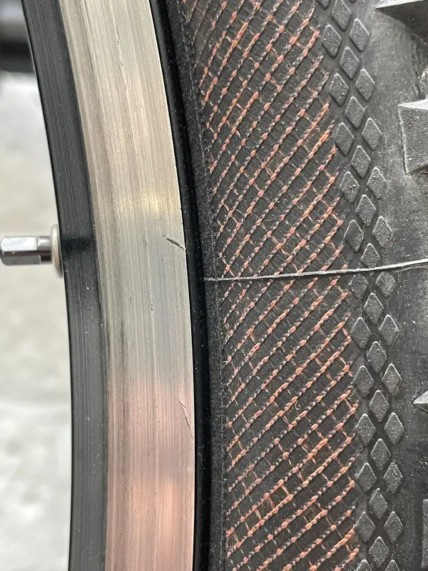

Am I in danger…?
Difficult to tell from pics, but if the rim surface is pretty plat, you'll be fine. Just looks like a couple of stone chips to me.
Those don’t look like cracks, it’s not metal separating, there’s deformation present which looks more like an impact of some variety.
Phew…
Thanks for your replies.
I did have a quick panic look for rims, there doesn’t seem to be much choice if ever a replacement is needed.
Anyway, no need for me to be worried.
Phew…

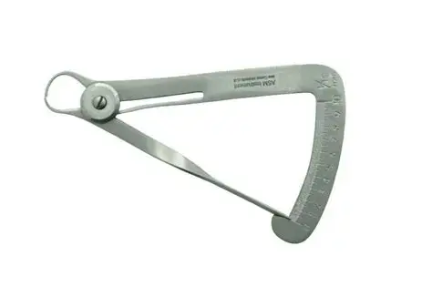

Cheap eBay Iwanson guage to accurately measure rim wall thickness, read of under 1mm = not good!
