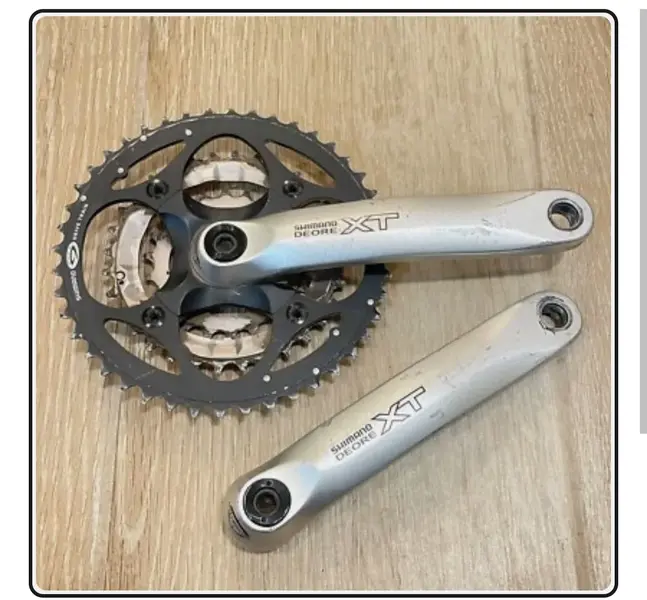

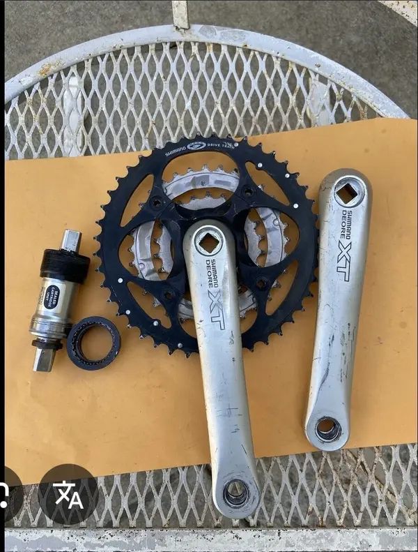

I am looking at a set of XT FC-M750 cranks that recently arrived and I am seeing a square taper fitting?
But I thought these cranks had a Octalink V2 fitting? Didn't they?
Did some early production have square taper?
Did someone machine out the Octalink to allow a square taper fit? Am I loosing it?
Please help. Thanks
Same typeface, same paint scheme, same spider, and when new, same chainrings.
Xt fc-m750, square taper.
Xt fc-m752 octolink:
Screenshot_20250525-155745_Firefox.webp Of course either if these could be found on an xt m75* groupset.
It's very unusual for shimano to change just the last digit of a 3 digit product code without it just being colour or another smallish detail.
Thanks guys. I think I was misinformed about the M750. The information I was referencing didn't break down the M751, M752 variations.
I am happy the M750 square tapers I have are legitimate as they seem to be very nice cranks.
