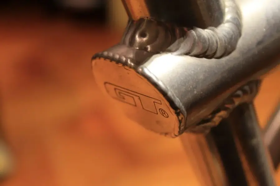

I plan to polish my Zaskar, I read a lot topic from it here.
I decide to use Autosol, without w/d paper, and steelwhool. It hasn't got scratches, just faded a bit.

So, should I try with just Autosol? :)
Not scratched, just faded, like on the picture.
This will be my first polishing, I don't want to harm the frame. :)
And how You use the Autosol exactly? What type of clothes, etc.
