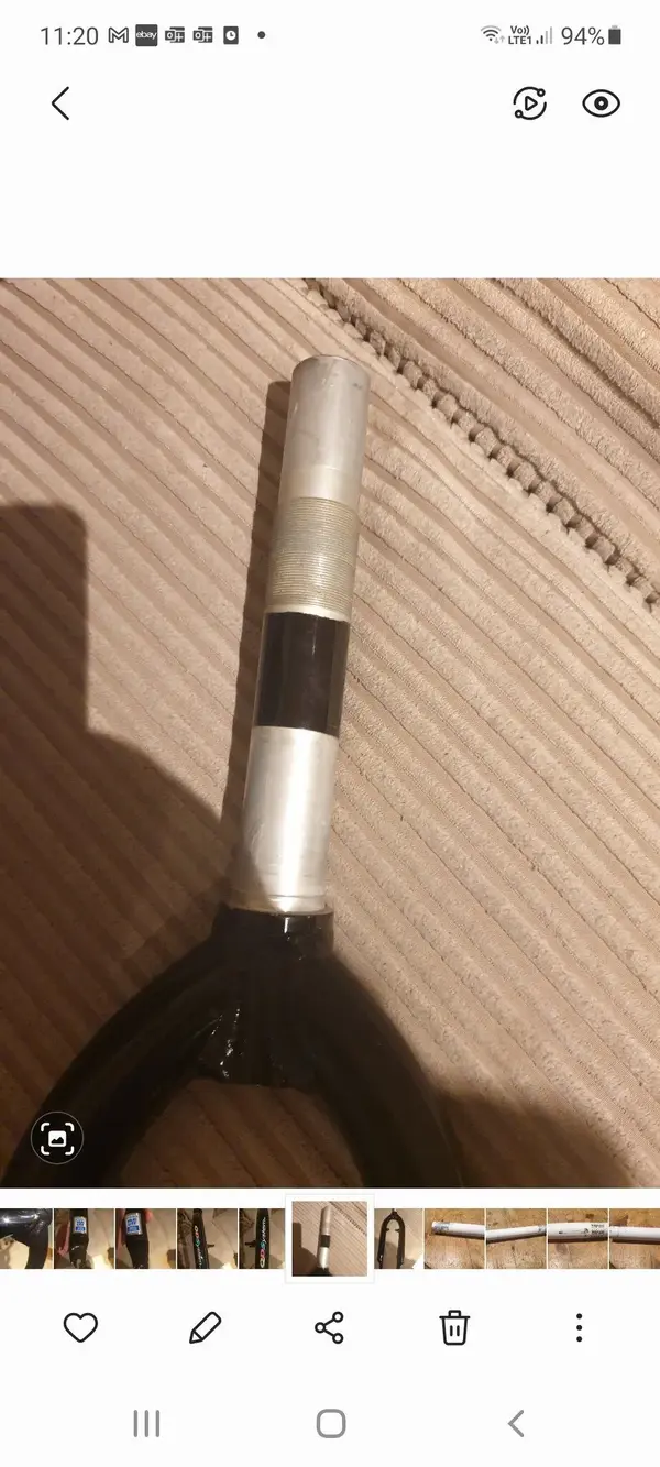

Is it these forks you have. These were from a 92 Al-Mega.
Thank you for that pic. I think that is the first time I have seen the top of a steerer that these stems were made for. 29.8mm seems to be a tandem seatpost thing and there are stoker stems made by Controltech and others with this bore, at the steerer end. I understand a little more now why they went down this route and how it all worked with the top of the steerer. I have a regular 1 1/8th" steerer tube and now I have one of the SJS shims on its way to me, to make the stem fit. Hopefully it will be just the ticket and the bars will be exactly where I want them.

They were specific, I had an alpinestars fork once, unnatural thing it was, as pointed out 1¼" threaded headset but awkward sized ahead stem, not sure if I used a shim on a 1¼" aheadstem or cut the threaded part off and used a 1" quill that fitted perfectly in the end.

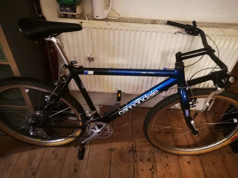

Is this the 28.6 aka 1/14 one and a quarter sized stem? I seem to have one on a cannondale and would like to reel in the bars a bit as sjs are out of decent human arm extenders
