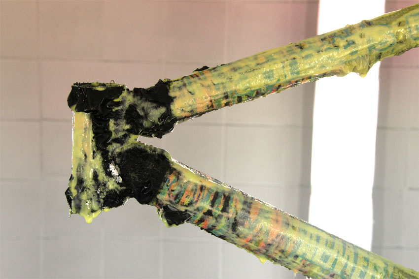

I got an Alpinestars frameset to restore. During the last 3 month i tried to find some decals for the frame but with no success.
Now i decided to rebuilt the decals as good as possible and paint them by hand.
I like to show some steps of the five day painting procedure.
But at first some impressions of the actual frame condition:
The first step is to remove all the old paint and decals. This needs one and a hlaf day because i use some pickling aids to strip the color.

That looks like the guy who goes in the acid in robocop!...yuk!...how do you then remove the goo from the frame?....

The "stripper" did his job well
...rinses off with cold water.
Water is only a good idea for the use on alloy frames because the acid in the paint stripper lets steel rust within minutes.
I use a hard brush to remove the rest of the color. Sometimes the color peels of completely and falls on the floor.
