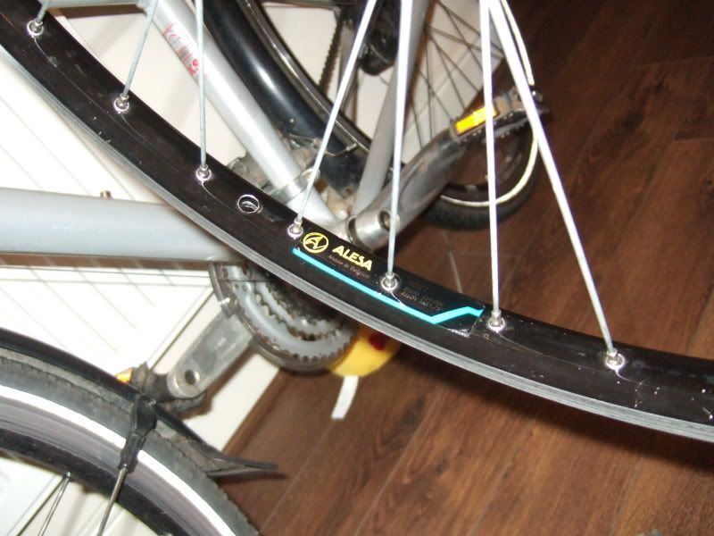

I got these on my raleigh
Alesa 6021
I weighed them up against my new mavic wheels (317?) and a clear 150g heavier! :shock: Well they are wide and look sturdy.
My Apex will fly with Mavics, 300g lost off the wheels, but these must be good wheels, the Apex was specced quite well, at least benchmark quality spec, whats really interesting is that these wheels are still round, dinged sure, but my mate hit a few curbs with em on his urban travels! :? and spokes are not so tight.
so question is, in a sea of Mavics and other top obvious brands and choices, are these any good? and am I likely to fold the feather weight Mavics! :o :D
Tourers generally love them...here are the generally held beliefs:
1 Thicker braking surfaces - so they last longer
2 Stronger areas around the spokes - Mavics had a reputation for cracking around spoke holes (probably because they were too thin).
So they are sturdy, durable kit. Clearly if you fold rims up regularly from jumping there is probably no added value. If you are looking for a solid workhorse kind of rim for big miles then they are worth a look.

Not brilliant, not the worst.
On a scale of 1 - 10, 1 being worst 10 being best, I'd rate these as a 2 poss 3.

Good rims those. Obviously not light weight, but they were not designed to be.
Look like 36 hole. You tend to get them on early '90s mid to high end British stuff, along with the eyeletted black Rigidas.

Yes, they are re-named as ALEX these days.
Ahhh that explains it. :idea: heavy sturdy and not as posh as Mavic etc
