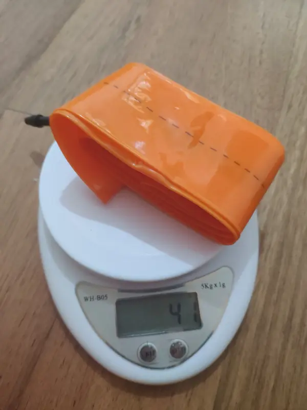

Received Tubes, 41gr each one, so 82gr, is a saving of more of 100gr vs previous Maxxis Flyweight**

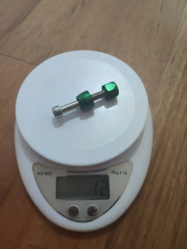

12gr for the Seat Binder: Control Tech Titanium** (same as listed).
So a saving of 120gr today.
I will update the main (1st page) weight results soon

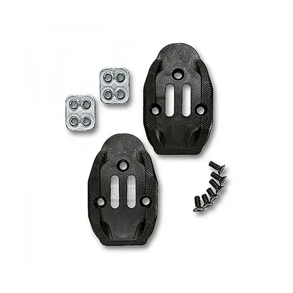

PD: The pedals will be on a road cycling shoes, I only find one adapter, that may work, but may need to make a perforation on MTB shoes for work, see attached pic
Any other adaptor for use road pedals on mtb pedals ? or any new show both either road / mtb to be compatible with road pedals ?
Well, obviously there is no law against riding your MTB with road race shoes. Riding the bike in off-road terrain it might just happen you need to get off the bike and walk a distance. And that's where road shoes with big cleats won't come too handy.

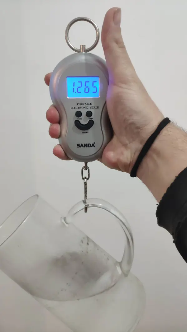

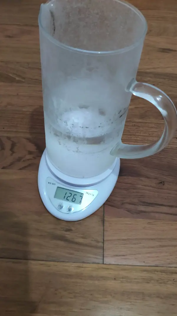

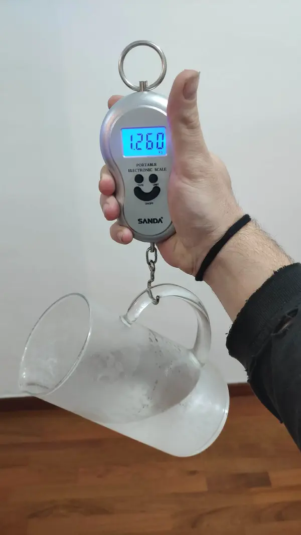

Weigh some things you definitely know the weight of to see how the scales are performing. Both the kitchen scales and the luggage scale you are using should not be trusted without first calibrating. Items could weigh less, or more, than you measure and by quite alot in my experience.
Cheap scales can have ranges that they perform well in, but are rubbish outside of that range, so Ideally you should have test weights from a few grams, in steps, up to around 10kg in this case.
That or just buy more expensive scales that have been calibrated, or get really friendly with your local postoffice/courier company.
I put a lot of water in to a jug.. As you can see. The balance is well, so weight is real. Fault tolerance as shown is +-0.05%
