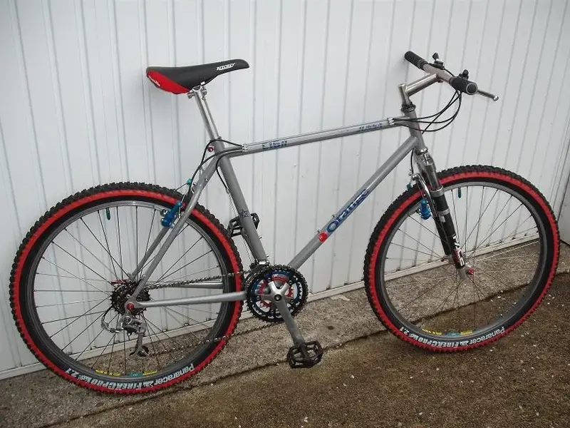

Number 1 - Forks? The first two obvious choices (Budget dependant) are finding a nice set of PACE forks, I currently have 2 C16R's running RC35's and also RC38's both with 1" Steerer and do the job perfectly. The other option is replace or service repair your Manitou's there will be someone who can help you in this area and many have even tackled the task at home. Either way its not a lost cause.

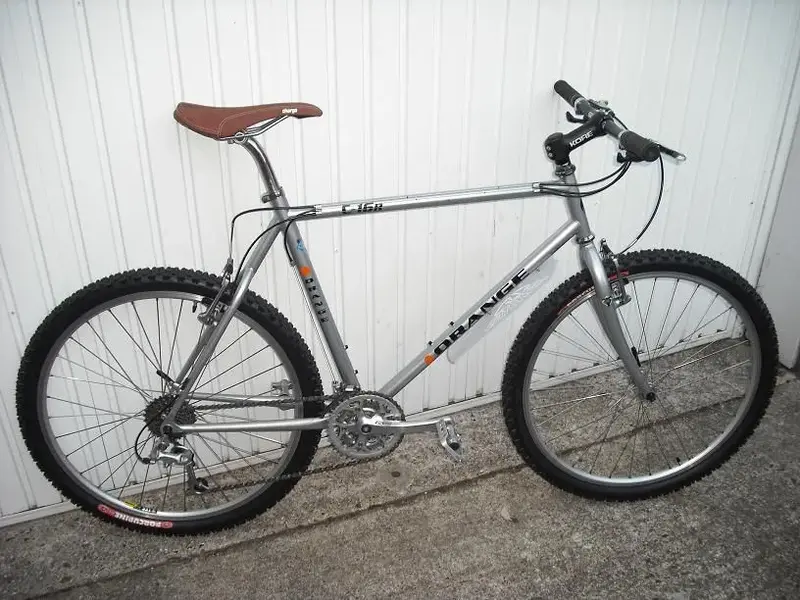

Number 2 - Quill Stems? My First C16R came with 1" Threaded Forks with a Quill Stem adaptor and shim and a KORE Aheadstem (Picture 1) which worked very well and served me until i sourced an original Orange SK8 Quill Stem, ditched the forks and went down the PACE Route (Picture 2). Quill Stems are in abundance and you can still get NOS Stems, I got a cheap NOS Kalloy UNO Stem for £5 short reach aswell, a quick search on evilbay will uncover a plethora of stems to suit your budget and needs. Or put a wanted add on the forum and someone will help you out for sure.

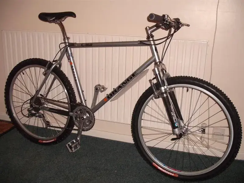

So all is not lost and to help re-ignite you passion here are my two C16R's both very different builds, one 1996 Original Spec, the other 1994 with a Retro Modern feel to it.
