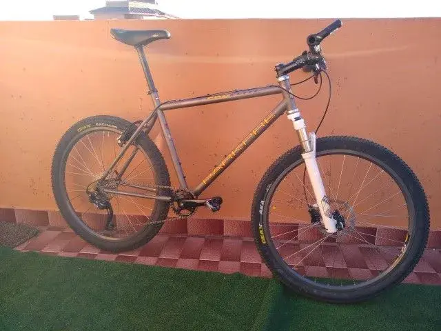

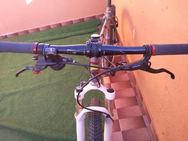

here are a couple of pics of mine, you can't see but the rear wheel is also a disc hub, doesn't look too out of place
the levers are obviously different, but they're not too noticeable, and more importantly the levers themselves have almost the exact same shape so they feel very similar to operate
I previously had a XT V levers, with an XT V at the back and BB7 at the front, that worked very well, but I had an urge to go hydraulic
Thank you!
Your bike looks superb and is inspirational !
Thanks as this is basically what I want to do or rather the only straight forward option for hydraulic
Just out of curisosity - what Hubs/ Rims?
Thanks
I think they're hope pro 3, and Mavic EX(can't remember the number), but they're rim brake rims.
If I ever have time and spare funds then I might swap the front rim to something similar but in a disc version, and the rear hub for the non-disc version, but I'm not really bothered. I bought them like that, at least they're compatible with any 26" wheel bike :)
