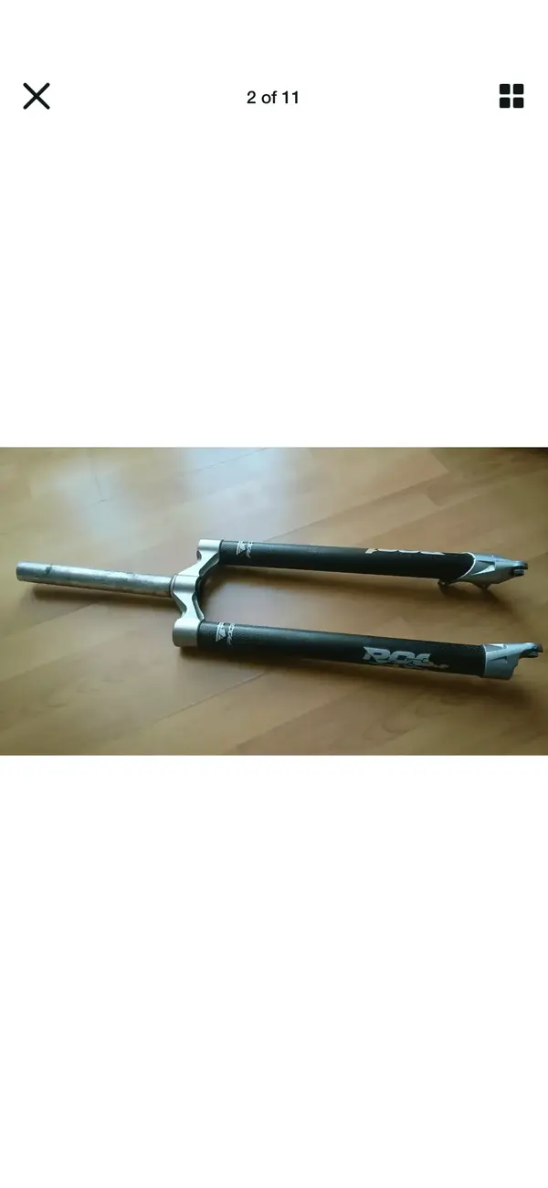

I’m building a Raleigh Dynatech MT4 back Up again.
Wanted some thoughts
Would a pair of Pace RC31 such as these (on sale on eBay) suit the frame?

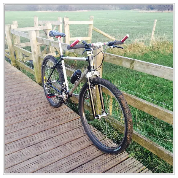

Previously I have RC30 as pictured.
Thanks

What's the A/C on the RC31s? If it's 440mm then I'm going to say no, it'll look like a chopper and handle like one.
Re: Re:
These are the old version - V brake bossed (without disk mounts) 420mm.
Re: Re:
66 triumph daytona":3mhtt4b7 said:
Doubtful.I had an MT3 and I think 395mm A to C was the sweet spot.
I agree - I’ll pass on these. My RC30’s were 390mm and these are 1.1/4” higher! Wouldn’t work
