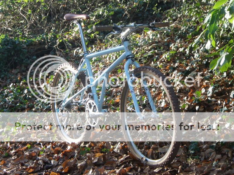

A Saracen by any other name - very (new) pic heavy...

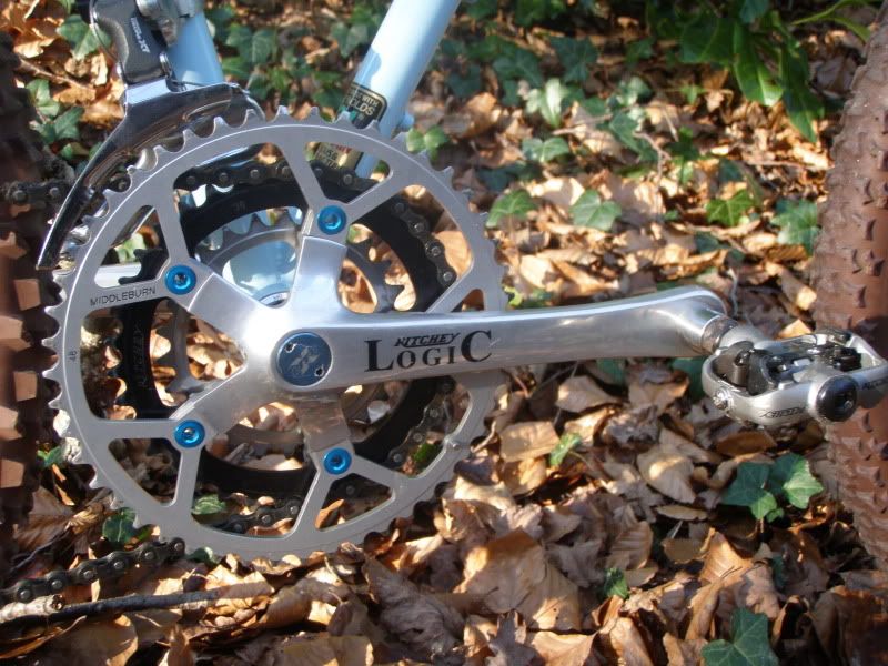

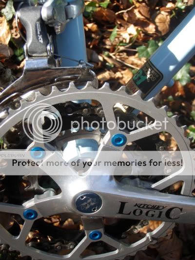

I can't even remember which was the first bit of Ritchey kit that caught my eye; probably the hideously expensive crankset...
Pedals mounted to 20mm stainless extenders to save my creaky old knees!
...which I then compounded by fitting a 'bargain' Middleburn ring and a NOS Onza Buzzsaw because I didn't want too much 'black' on the bike and the OEM rings were :oops:
I was originally going to fit some tourquoise'ish Ritchey clipless pedals but decided they clashed with, rather than complimented, the paint. As I had already bought the grey XTR cables I found some grey pedals to match, followed by the blue ano bolts and X Lite crank caps to 'bling' it up a bit, and have to say I'm well chuffed with the overall effect.

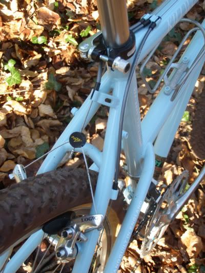

Continuing the subtle blue ano theme I fitted an original alloy Avid Rollamajig (that I nabbed off the Kilauea before passing it on to my daughter...) and a 13T CNC'd lower jockey wheel (the upper is a gold CNC'd 11T); the idea being the larger radius is better for chain life/performance - allegedly. :wink:

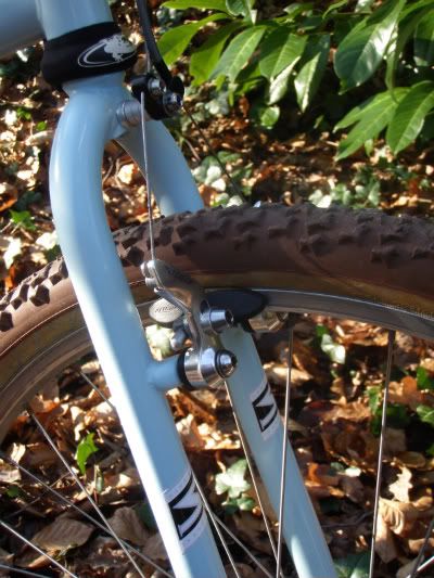

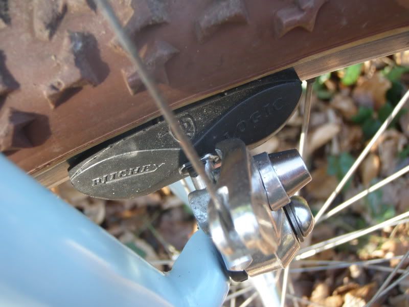

The Logic canti's...
...were (happily) a bargain compared with some you see on eBay, and look so much nicer than any model of XT (IMHO...)
..........................................................................................................small Saracen decals to echo original Kona 'thumbs'
AND before anyone points out the obvious ( :lol: ) yes, I know the cable angle is all wrong with the power-hanger on the suspension-corrected fork; but with the added efficiency of the hanger the front break is still powerfull enough to pull stoppies even with my current bulk propelling it along! :o

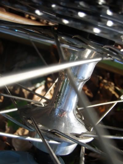

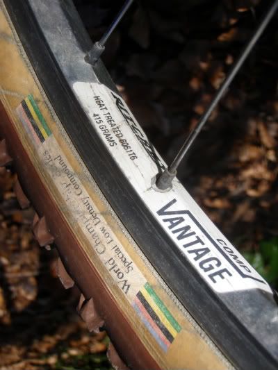

...the wheelset I had originally earmarked for this build was a pair of Mavic 517's on XT M750/751 hubs that used to hang off my Kilauea, but in the interest of continuing the Ritchey theme I snapped up these...
...at a bargain price, which is more than can be said for my tyres of choice :?
The eBay listing stated that the 'tread on one was slightly worse than the other' but when they arrived the 1.95 had a 20mm cut right through the casing dead-center in the middle of the tyre! Not happy but, BiTD I used 1.9 Tioga City Slickers for my commute and as they became harder and harder to get hold of I used to eke them out to the bitter end; the side walls used to go first, but I used to glue patches of thin plastic sheet over the damage without any ramifications (apart from the odd looks I'd get at the sight of my increasingly tatty sidewalls - 'Just how do they hold air?')
A quick rummage through the recycling box in the kitchen turned up the clear plastic top from a confectionary box, about .5mm thick and quite stiff; one 10cm x 4cm patch later (held in place by the tube) and the tyre was good to go again... :wink:
Didn't stop me buying a heart-attack inducingly expensive NOS pair for when these do give up the ghost though!

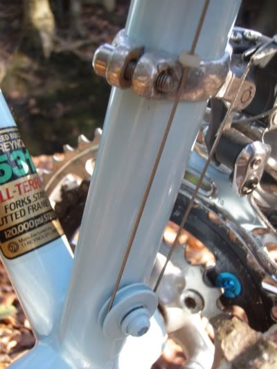

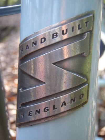

My two favourite fine-detail touches; the inverter pulley for the front mech. was rusted and seized on its post when I got it so I freed it up and left it in place when the frame went off for coating - I really like that colour-matched little detail. And the superb pewter headtube badge; 'nuff said 8)

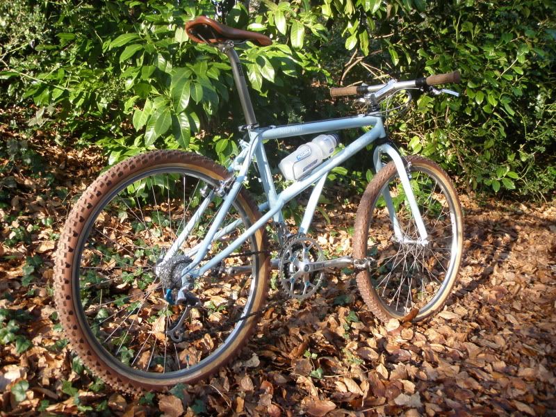

...but I think I can safely say that, despite being the major Kona fan that I am, this...
...really does look like becoming my favourite 8)
.........................................................................the Kili that never was... :wink:
