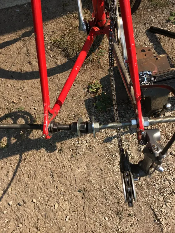

You can sometimes find inexpensive 70s - 80s Japanese road bicycles for a good price. They often had quality tubing or at least very good tubing. Get one with butted tubing, unless it’s for gravel or touring with a load. Perhaps replace the wheels with quality ones with better rolling hubs. I just bought a better used wheel set for a similar project but I plan to eventually use carbon rims. I paid 200 bp this summer for a Panasonic built bicycle with Columbus SL tubing. I don’t like SLX tubing, it whips around too much on high speed downhill right angle corners. I have the same problem with my Paramount with light weight oversized tubing. I used the Panasonic all summer but it needed different bars, stem and seat post so it would fit better. I’m using a 10 speed gear cluster so I spread the rear triangle and aligned the drops. I have put on a carbon seat post as the original was too short. I also used wider take off carbon bars. It’s going to have the shifters in the brake levers. It will never be as fast or as light as a high quality full carbon bicycle. But it was already pretty fast and very comfortable for long hauls. I use a Brooks professional saddle, which is comfortable for me for about 100 miles. Eventually I’ll replace the crank, chainring and derailleurs, if the parts ever get here. Also check out the rolling resistance of tires on the net before you buy new ones. You can get a pretty fast and reliable set without breaking the bank if you do your homework. Wider fast tires might not fit so make sure they aren’t too wide for the vintage frame. I like moderately fast rolling 28s for all round use. For you, my advice is to get a good vintage Japanese bike, then you can ride it now, upgrade or sell it later. Vintage Panasonic bikes are starting to get expensive but there are a lot of alternatives. I recently gave several away because they were too big to fit me and needed work.
You can sometimes find inexpensive 70s - 80s Japanese road bicycles for a good price. They often had quality tubing or at least very good tubing. Get one with butted tubing, unless it’s for gravel or touring with a load. Perhaps replace the wheels with quality ones with better rolling hubs. I just bought a better used wheel set for a similar project but I plan to eventually use carbon rims. I paid 200 bp this summer for a Panasonic built bicycle with Columbus SL tubing. I don’t like SLX tubing, it whips around too much on high speed downhill right angle corners. I have the same problem with my Paramount with light weight oversized tubing. I used the Panasonic all summer but it needed different bars, stem and seat post so it would fit better. I’m using a 10 speed gear cluster so I spread the rear triangle and aligned the drops. I have put on a carbon seat post as the original was too short. I also used wider take off carbon bars. It’s going to have the shifters in the brake levers. It will never be as fast or as light as a high quality full carbon bicycle. But it was already pretty fast and very comfortable for long hauls. I use a Brooks professional saddle, which is comfortable for me for about 100 miles. Eventually I’ll replace the crank, chainring and derailleurs, if the parts ever get here. Also check out the rolling resistance of tires on the net before you buy new ones. You can get a pretty fast and reliable set without breaking the bank if you do your homework. Wider fast tires might not fit so make sure they aren’t too wide for the vintage frame. 28s probably won’t fit on early 90s frames. I like moderately fast rolling 28s for all round use. For you, my advice is to get a good vintage Japanese bike, then you can ride it now, upgrade or sell it later. Vintage Panasonic bikes are starting to get expensive but there are a lot of alternatives. I recently gave several away because they were too big to fit me and needed work. Here is my drop alignment with a homemade tool after the stays were spread so the 10 speed cogs would fit. 2DEC5473-C7FF-42BF-869C-D77449EE3DE0.jpeg 19887D73-DB6C-4469-918F-E75720A32CD8.jpeg
