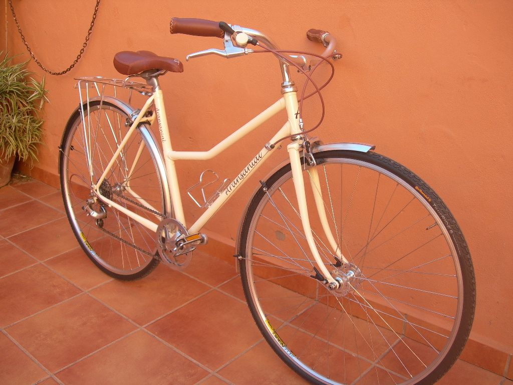

Cutting a long story very short, I got this finished a few days ago, just in time for Mrs foz's birthday :)
more pics and details when I can!
I finally got round to taking some better pics of this one over the weekend so thought I'd update the thread with more build details and better pics (better late than never!)

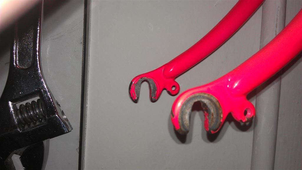

The fork tips had been filed out (slots made larger) at some point, so I had the car workshop over the road fill the slots in slightly with more weld, then filed it back to leave the slots the size and shape they should be.

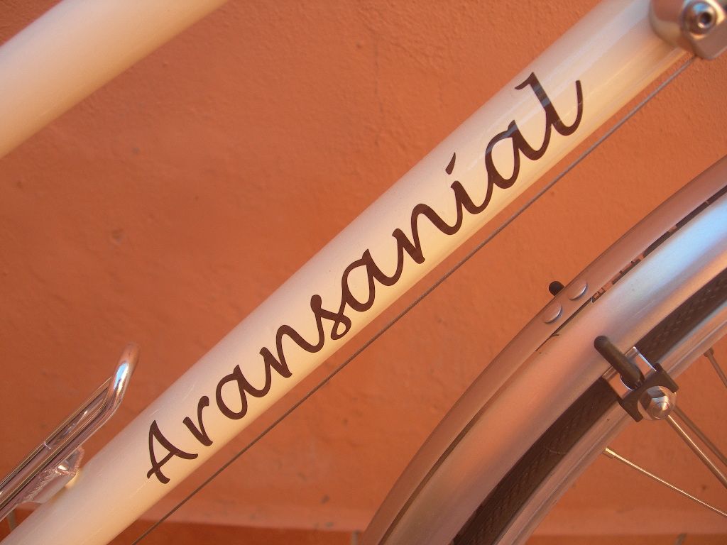

Frame and fork then went for paint, and I had the decals cut. The decals took three tries to get right, but finally worked out pretty good (first time the printers cut all the lines, not just the outline, so instead of letters they were just lots of little triangles and impossible to apply, the second time they set the knife to cut too deep and it cut the backing paper too, so again, impossible to apply. third time came out good though :) ). Skimping on the paint cost, I fitted the decals myself and went over the edges with clear nail polish to stop them lifting.

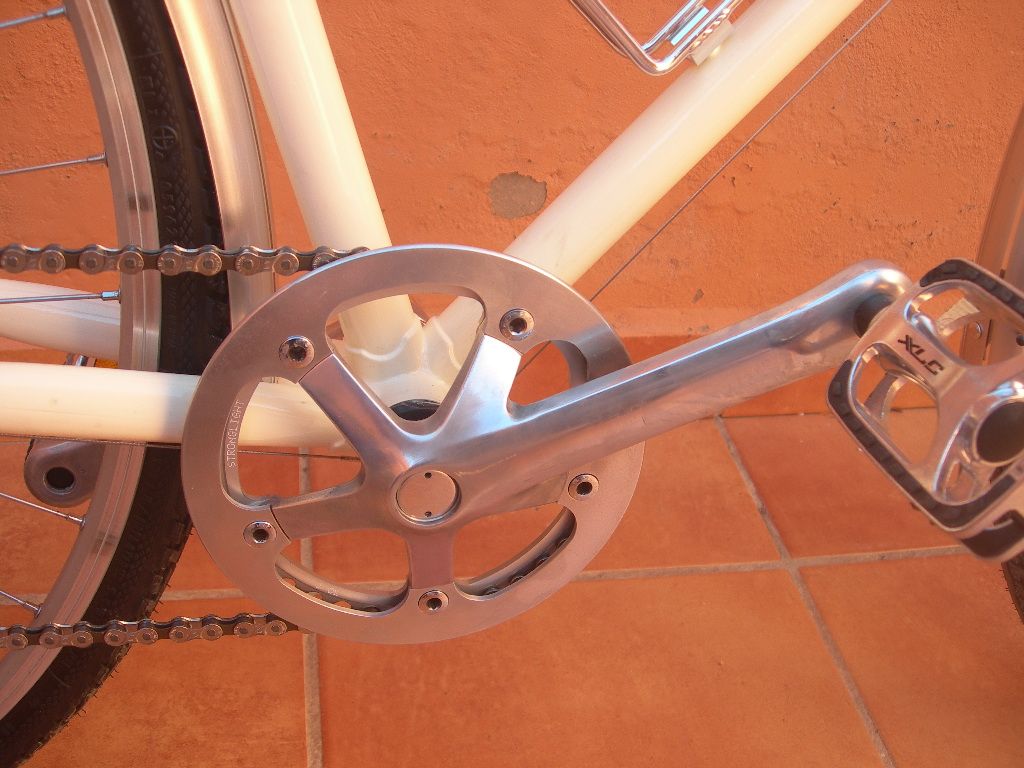

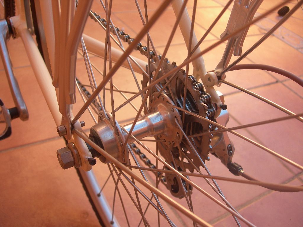

Rear hub and cranks came from my parts bin and were given a decent polish to tidy them up - they're RX100/Exage or similar.

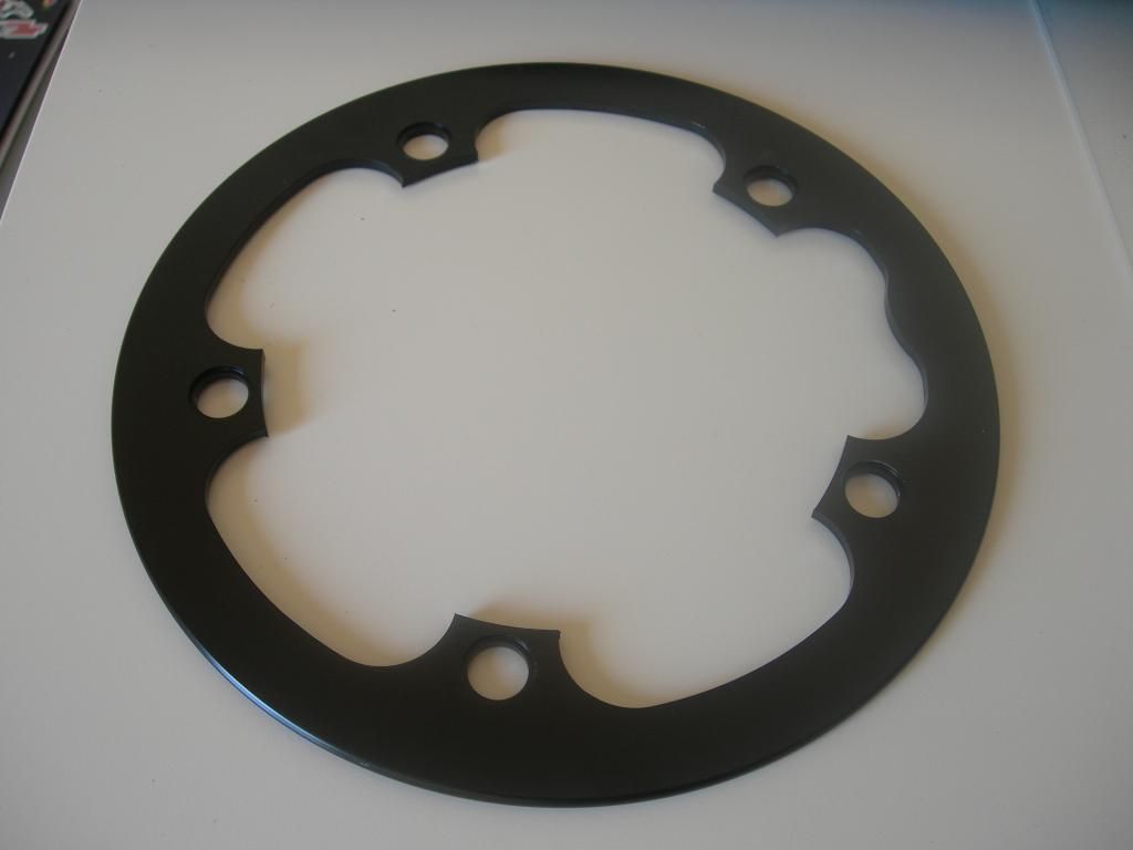

The chainguard was bought new, but was black (why are parts only ever available in black and not silver?). I wanted as little black as possible on the bike, so it went into a plastic bowl with some caustic soda for a few minutes, then a quick polish, and turned out quite nice!

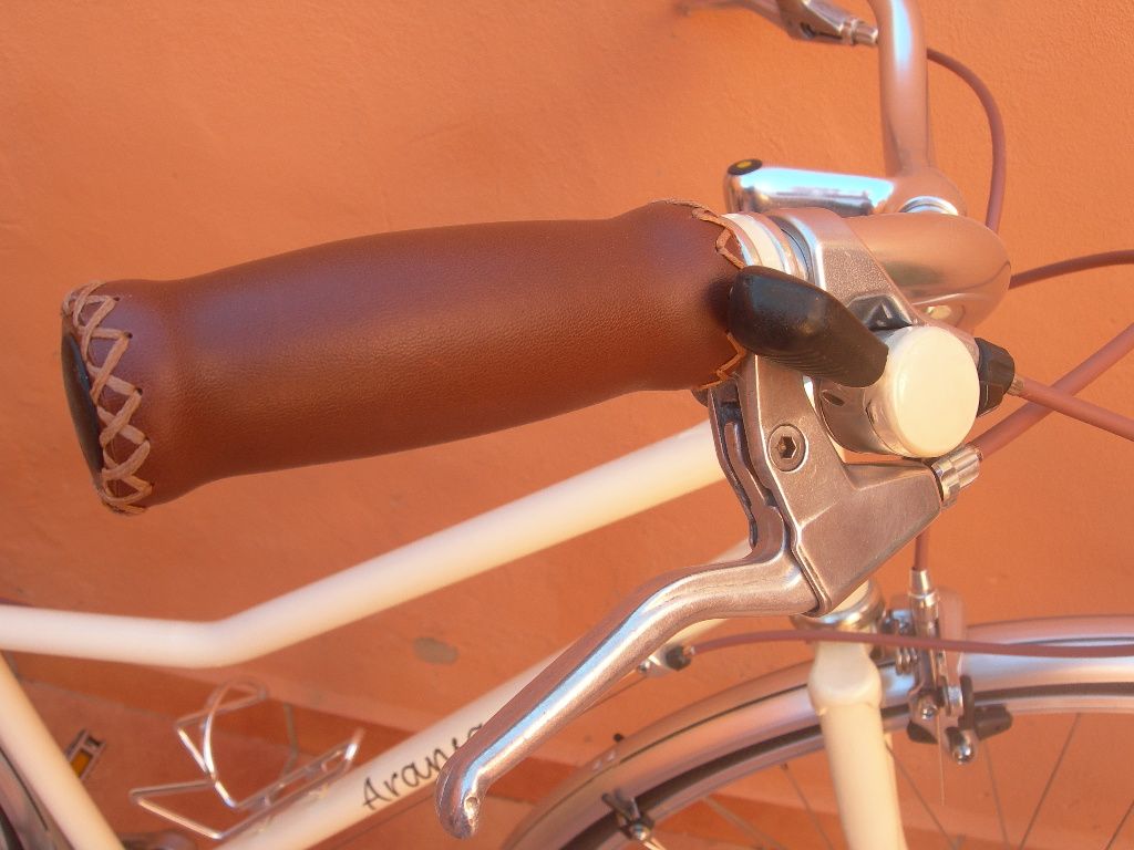

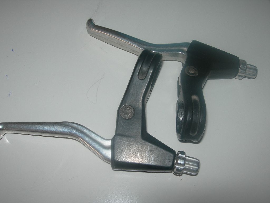

The brake levers were also a parts bin special - they had black mounts and silver blades, but the black came off nicely with paint stripper, and they polished up quite well, and I filled in the slots with matching paint.

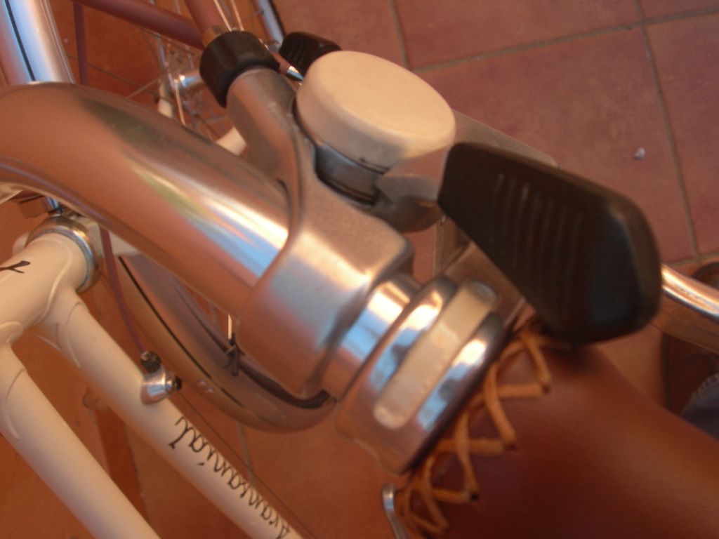

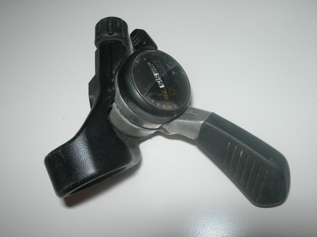

Same story with the shifter - I wanted something easy to use, and good looking. What could be easier than a thumbie? Needed to lose most of the black though... more caustic soda, some time polishing, and a little paint :)

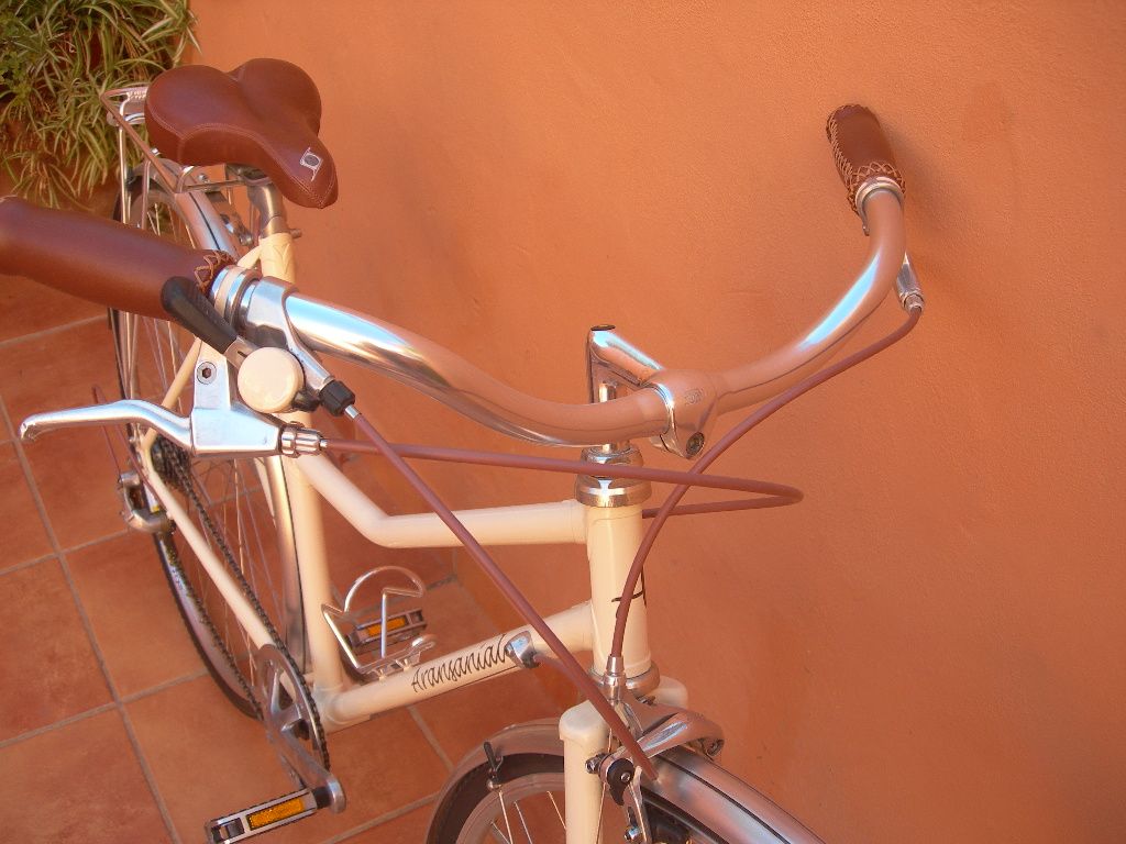

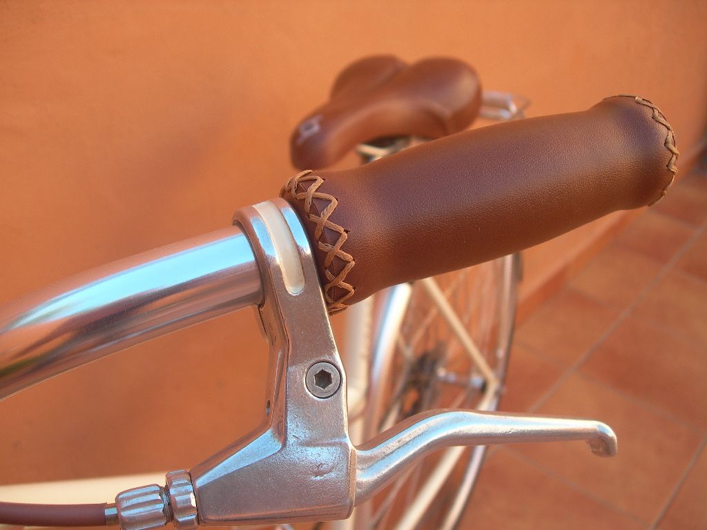

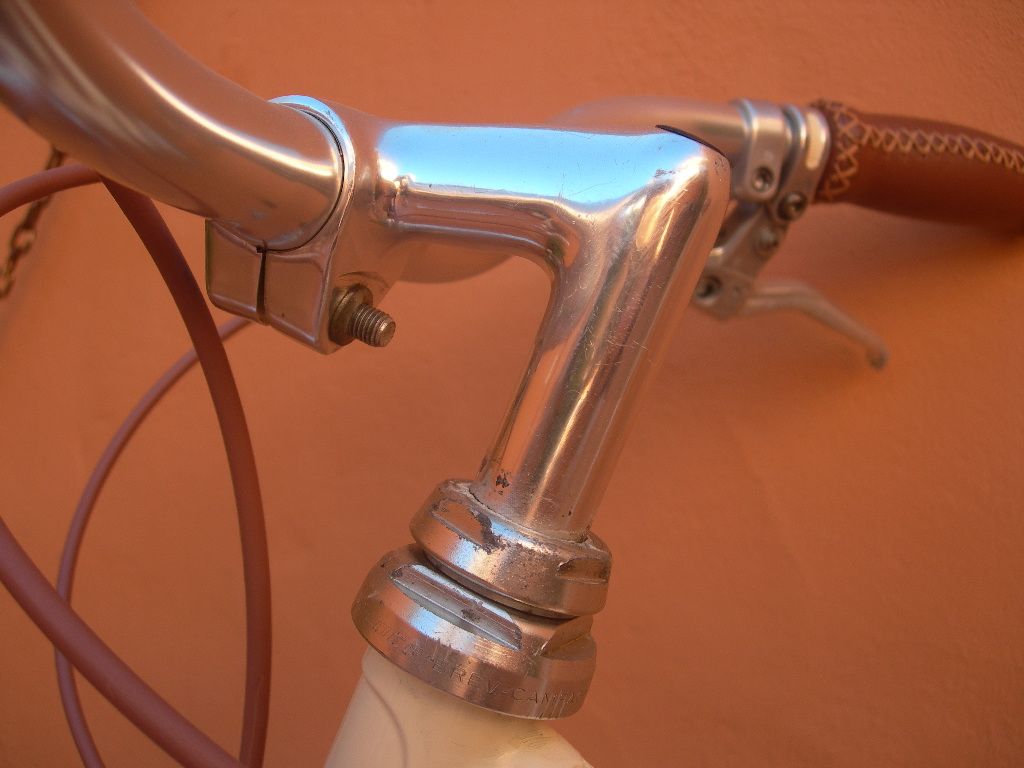

Headset, BB, stem, front wheel, rear rim, spokes, all were from the parts bin. Bars, rack, mudguards and pedals were new. I had an old Raleigh ladies saddle that I wanted to recover, but after thee attempts and not being able to get the fabric (fake leather) to sit properly, I gave in and bought a new one, along with matching grips.

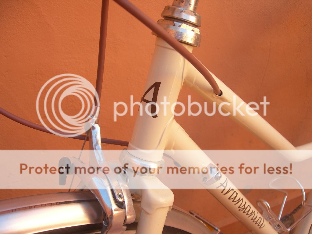

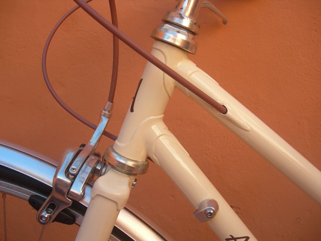

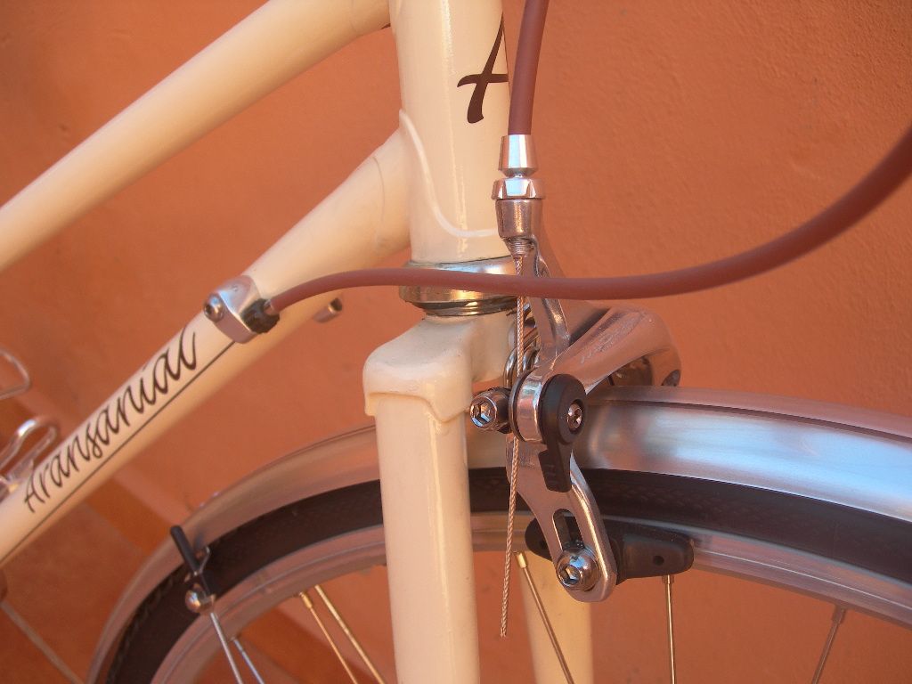

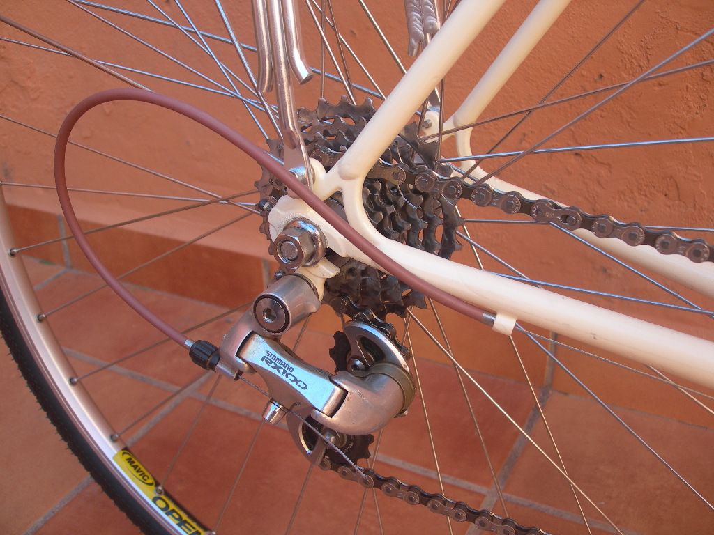

Brown cables aren't available (I think brake cables are, but gear outers for indexed gears aren't), I didn't want black, and white wouldn't fit right with the frame colour. So I made them myself :) Standard white cables, covered with brown 6mm 2:1 heatshrink. I nearly burnt out Mrs Foz's hairdryer while shrinking them on, but I think they turned out pretty well in the end!

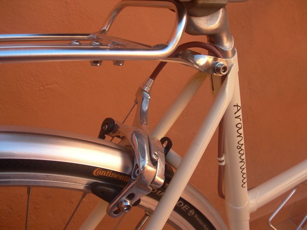

The seatclamp bolt is a standard 6mm (might be 5mm?) bolt, with the spacers and nut from a V-brake brake pad to hold the rack supports at in the right place and clamp everything down.
Overall I'm very pleased with it, and Mrs Foz is also very happy with the outcome! She's even starting to like cycling :lol:
Now for some pics of the finished bike!

(bars might need shimming)
