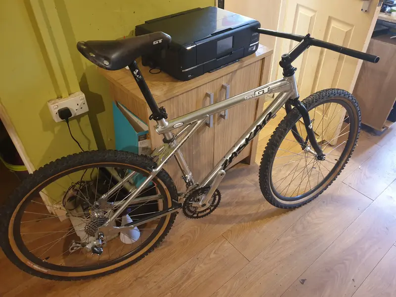

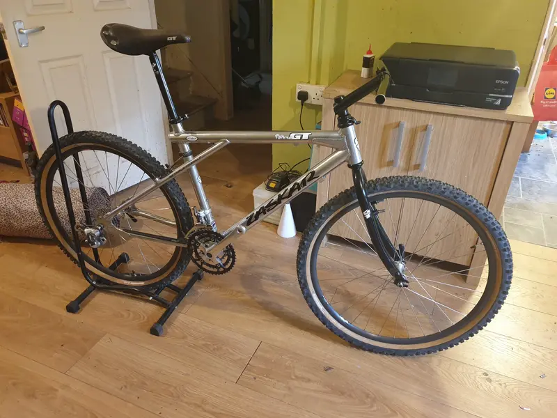

The forks are now fitted and having a play around with the different stems I have.
Should I use 120mm lower rise or 135mm higher rise?
See below fitted with 120mm stem and 135mm
I am leaning towards the shorter stem, to keep it consistent with my other retro GT's and 120mm is correct for the frame size.
