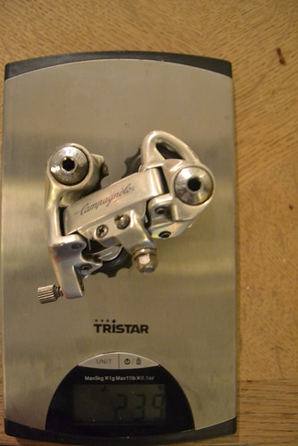

swapping PART II (Athena rear mech)
for this Campagnolo Record rear mech I got off a bike Im building up for someone that was all shimano except for this part..
+ saves me 14 grams :)
+ has also got pullies that are in better shape
+ the logo is better
+ it cost me nothing, so It saves me, let's say €10

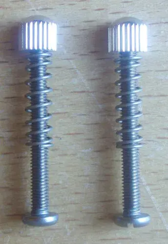

Bought these "REAR END FRAME DROP OUT / REAR WHEEL ALINEMENT ADJUSTERS" on ebay..
PRICE= €8 (posted)
WEIGHT= my estimate 10g maybe? -> scale says 10grams!
I've spend €200 on the project untill now btw..The budget side is still ok,
the weight side will be harder I guess.

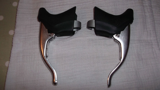

Campagnolo Athena levers in a nice condition with black hoods:
Thanks willsdad!
PRICE= €39,75 (postage and paypal fees included)
WEIGHT= Velobase says 230 grams, scale says 231grams

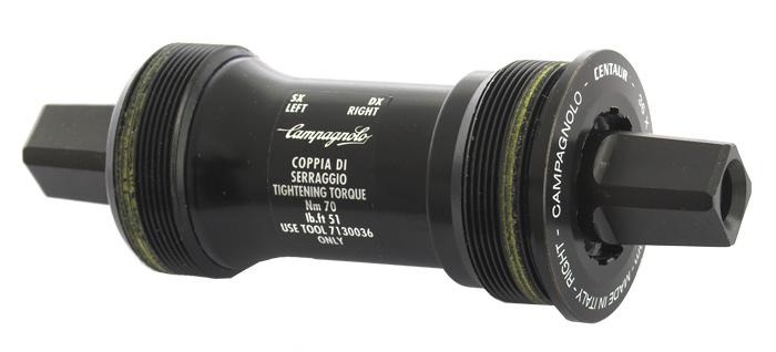

I've ordered a New Campagnolo Centaur Bottom Bracket yesterday
PRICE= €42,1 (posted)
WEIGHT= 233 grams (claimed); scale says 239g
First Campagnolo Component that I ever bought New 8) Little bit excited yes

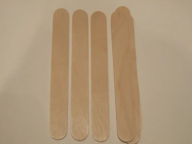

Bastos87":29otf4om said:
Woz":29otf4om said:
Wouldn't the Victory lollipop sticks be lighter?
the what ?! :), sorry I don't have a clue what u mean with "the victory lollipop sticks"...
:oops:

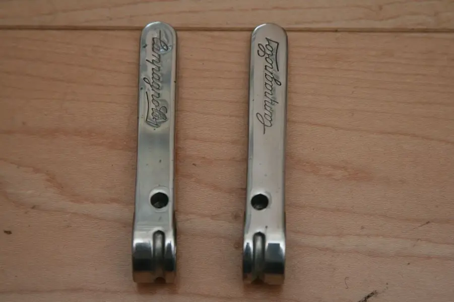

Sorry, it may have been cryptic. Pictures are worth a 1000 words.
