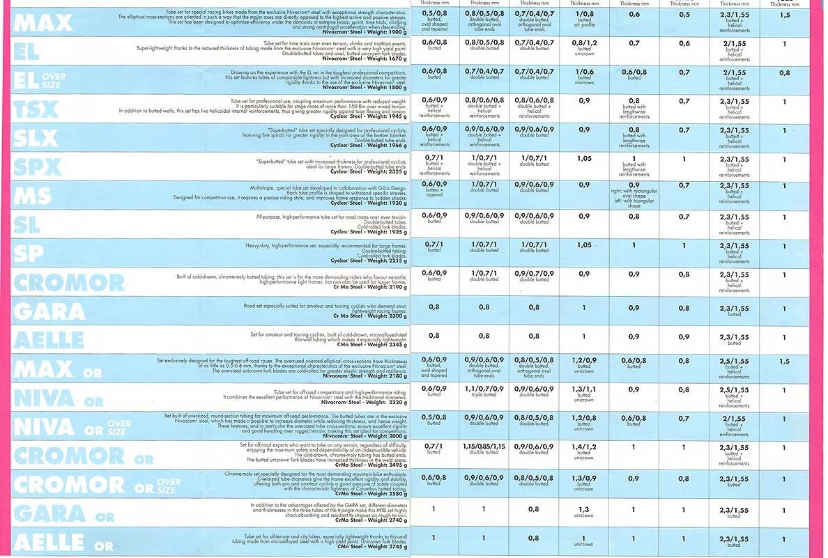

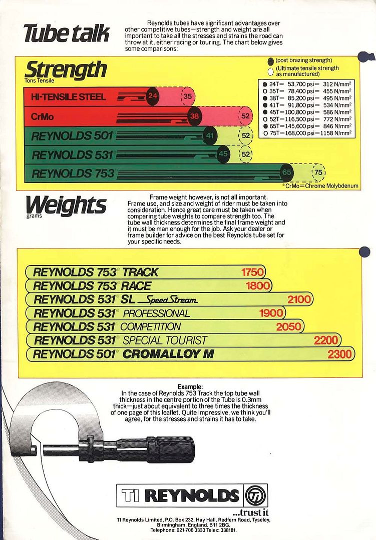

i'm getting confused with all this overloading of what should be simple information. "in my day" it was as simple as this:
vs.
there's your tube/ there's the weight/ and KA-CHINNNGG!! there's the price!! :shock:
when i scour the reynolds site, i need a degree in chemistry to understand the information tables and not a single mention of the tube set weights!! what rider in their right mind gives a toss about "bainitic microstructure" or "martensitic-aging "??! it would seem that reynolds have completely forgotten that "joe average, the bike rider" is the one who's interested in their tube sets and not sigmund freud!!
:x
does anyone out there have evidence of the weight of the current reynolds range of tube sets?
