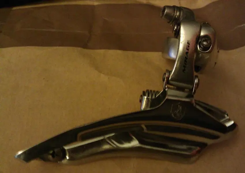

I've managed to source a braze-on Campagnolo comp triple for £15, and was hoping to bodge the band part from an old SunTour front mech that I've got. Might you have something nicer? I reckon I could probably sell on the one I've bought without making a loss.
28.6 Mirage triple band on £15 posted
