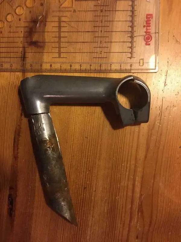

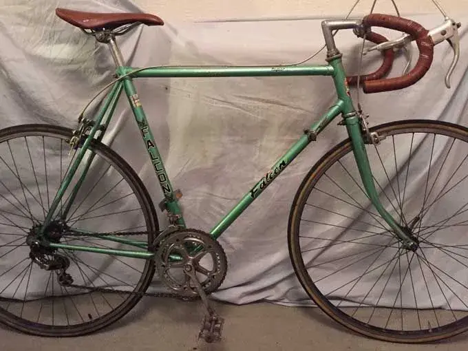

I recently acquired a Falcon Rapier frame and wheel set from ebay with the original aim of making it work and selling it on. Unfortunately it had a pig of a stem stuck in it and having got fairly intimate in the course of its removal I have decided to have some fun with it instead.
It seems to be a fairly standard quality steel frame that I'm guessing is from the 80s, it carries a 'built for Elswick Falcon' sticker, and is quite tatty in places. Unless anyone can advise me otherwise before I get stuck in with the wire brush, I am planning on sanding the paint off, giving it a funky paint job, and using it as a city beater.
As part of this I will obviously be requiring a new stem. If anyone has one knocking around I will gladly take it off you for the price of postage and a couple of pints of beer!

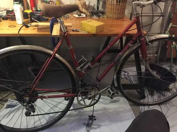

Not long after, I noticed my mum's old bike could also do with some attention. She doesn't ride it anymore, but it has been passed around friends and family over the years and has now been adopted by my sister. She will be returning home in three weeks, and I have decided to give it a once over as a sort of welcome present!

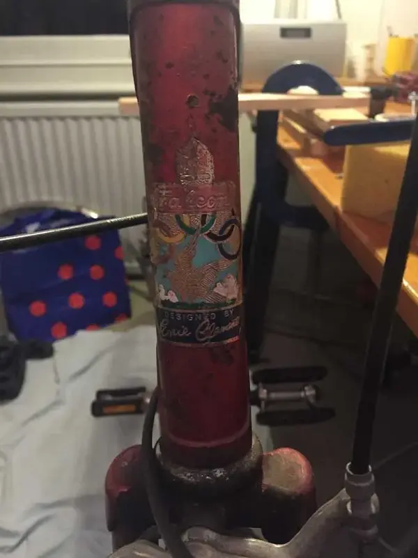

On closer inspection, it turns out that this bike, also a Falcon, was built for my mum at Overbury's in Bristol in or around the 70s. The headbadge carries 'Designed by Ernie Clements' and the remains of the Reynolds 531 stickers are just about visible. It seems to be in pretty good condition and mainly just needs a good scrub and regreasing. I was pleasantly surprised when the seatpost came out effortlessly, although having just spent the weekend wrestling with the previous stuck stem, I have not dared unscrew the headset yet, for fear of what I might find.
Getting to the point...at some point someone has decided to remove the downtube shifters and bodge a rather offensive Shimano sis thumbshifter onto this otherwise handsome bike. Neither my mum nor my sister particularly like taking their hands off the bars to change gears, so I am looking for suggestions as to what might be a more sensitive alternative to both the DT shifters or the plastic thumbie?

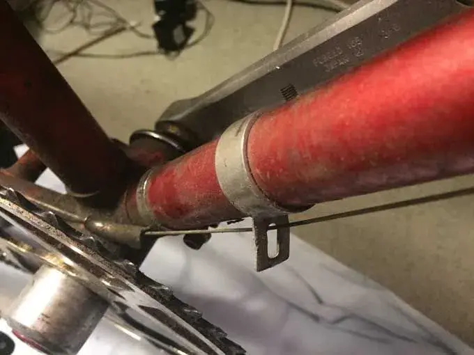

Also, there were a plethora of wrap around cable stays and the like holding all the cables in place. There are no brazed on cable stops on the frame itself, would this be how the cables were originally fixed?

here are some pics of the Rapier

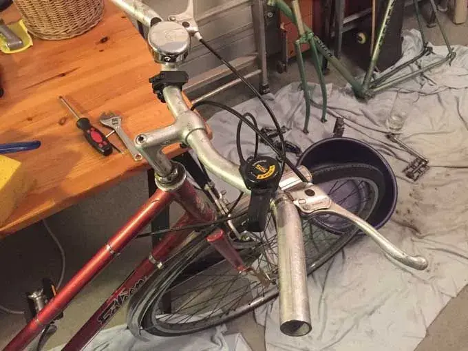

And the Overbury's bike. Sorry for the poor quality pics
I've got a real soft spot for Falcons (currently doing up a 70's Falcon Olympic). and the two you have there, though not in the best of shape are still nice looking bikes.

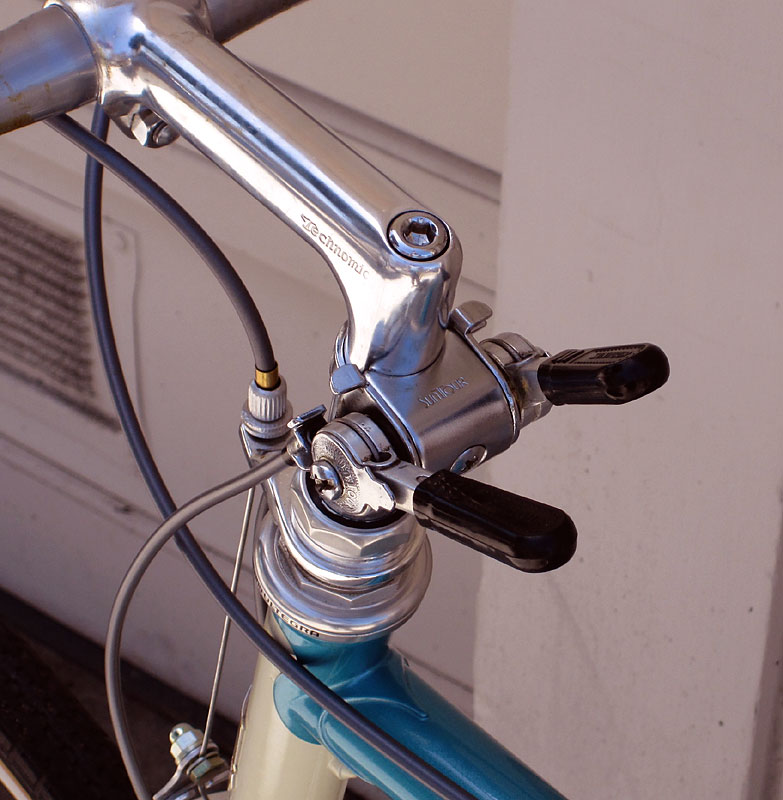

With regard to shifters for your sisters bike, you could perhaps use stem shifters? something like this:
And as for the Rapier, if you're going to use it as a beater bike, I personally would clean it and ride it as is! Personally I would also change the saddle and bar tape, but that's just my preference (not a big fan of the colour of those charge saddles)
Sorry I cant help you with a stem! but I look forward to seeing how both these bikes clean up.
Hi mate, thanks for the reply. That looks like an good solution, cheers. Although it would still require taking one hand of the bars, but that might be ok, seeing as its not down there on the downtube. I'm also wandering if there exists an alternative thumbshifter that is just more in keeping with the rest of the bike?

I suppose an alternative solution could be bar end shifters as opposed to stem shifters, slightly more in keeping and you don't leave the handlebars to shift? I don't have much experience with bar end shifters, but loads of people do on here and can give you a better steer.
