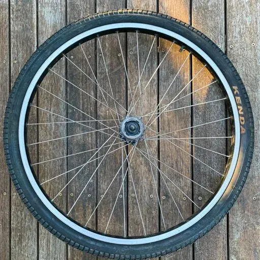

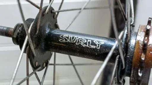

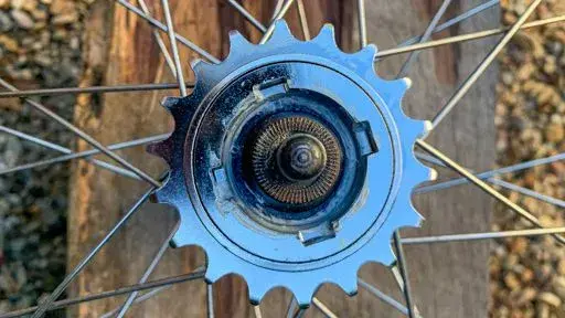

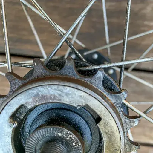

More hitches along the way: this is the rear wheel that came with the frame -- nice Surly flip-flop hub and no-name rim. It needs a new freewheel or sprocket -- you can see how hooked the teeth are. I bought the Park tool for removing the freewheel, but it's well and truly stuck. You can see where someone's been whacking the lock-ring with a punch so perhaps that's why the previous owner threw it in with the frame . . .
Anyone have any tips as to how to get this done without wrecking the wheel? I'd like to get it done at home rather than cave in and go to a bike shop.

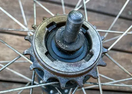

Some more views of the worn and stuck freewheel.

Freewheel tool in vice, grip tyre, turn wheel. Try with 2 people.

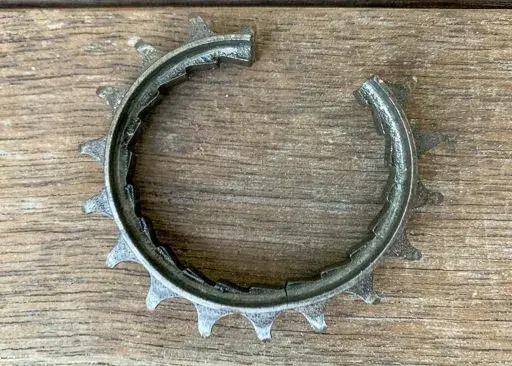

Yeah that was the first thing we tried but it was too stuck -- and the slots were sufficiently knackered from being hit with a punch or screwdriver that we couldn't get the freewheel tool to grip enough.

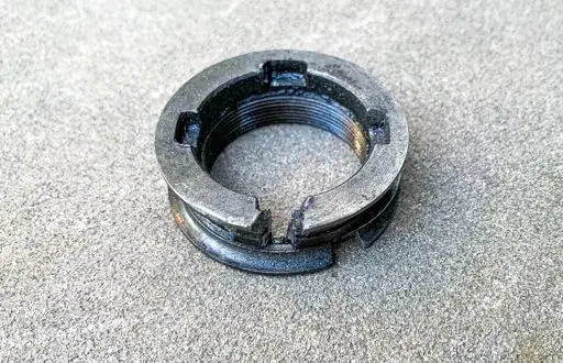

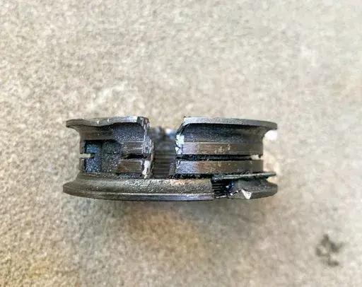

So it was out with the Dremel. It eventually worked -- there's a small nick in the hub flange despite my best efforts, but otherwise all's good.

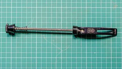

Ritchey skewer from the parts hoard below.
