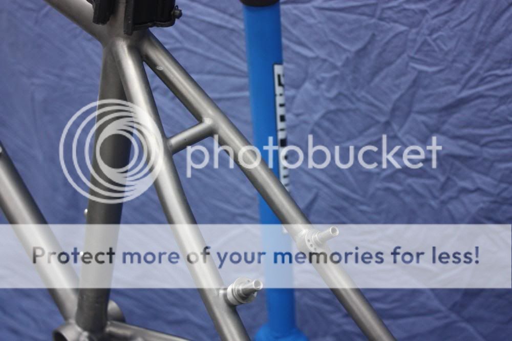

Ibis suggests Steve Potts for any work and who am I to argue. His name alone conjures up all kinds of mountain bike awesomeness. Can hurt that he's won awards for his Ti framework. So the frame was sent off to California for Steve to work his magic. Here's how the frame looked before it's trip to the spa,
Like nipples on a man,
So long stud,

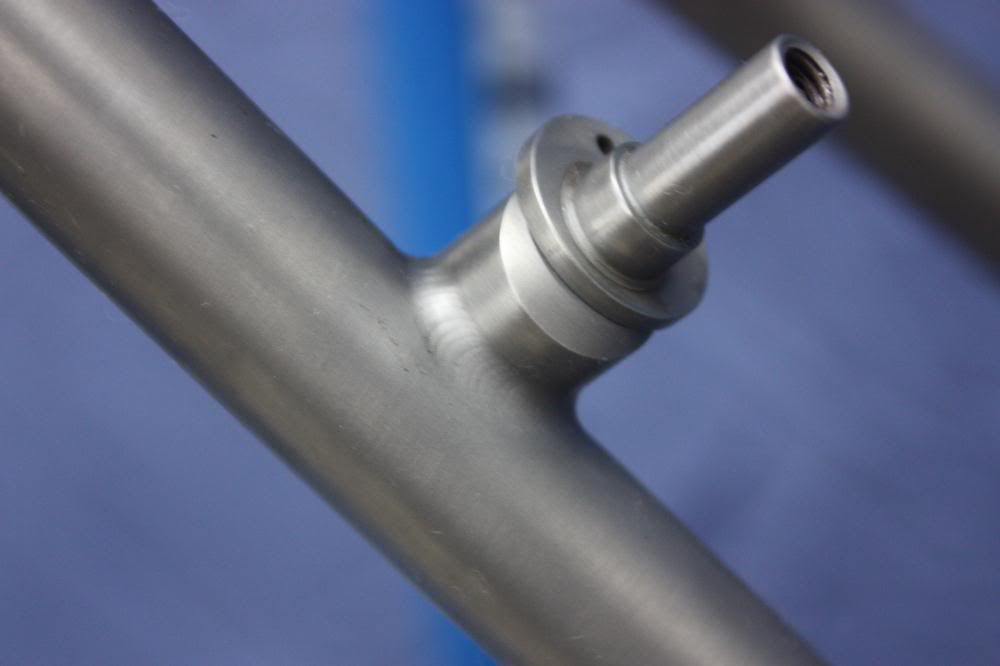

Canti studs were lopped off, a new excellently designed IS rear disc mount and straddle cable housing stops (for full housing to the rear disc)were installed, the frame was refinished and new decals (courtesy of Chuck Ibis) were put on. I got the frame back and marveled at Steve's handiwork. The man is a master. I'm honored to have someone of his caliber to lay hands on my frame. I should've asked him to sign his name on it! I got the frame back just before a big move so the frame was boxed up :(

that is more than just a disc brake mount - it also strengthens the stay.
