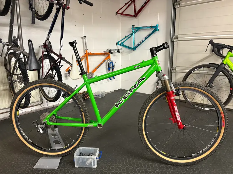

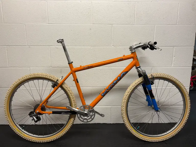

Made a start on actually assembling these two. Mainly to find a direction , work out what I need and also actually make some progress.
The 97 is going to be mainly silver parts - M739 , middleburn , SID and likely some X517 wheels or Crossmax.
View attachment 964724View attachment 964725View attachment 964726
The 98 is going with black parts as much as possible. Brakes may end up being changed to XTR. Wheels will be Crossmax and it’s likely going to be m950.
I’ve decided to go with a 98 Z2 in this striking metallic red colour to complement the green sparkle in the frame. Thomson stem and post , and hopefully some black Raceface when I get some.
I can’t lie that pressing the CK into this frame made me very nervous even with a slight mod to it.
View attachment 964727View attachment 964728View attachment 964729

Yeh I was super careful. Lots of checking and slow progress. The cup has had the relief channel added so hopefully will be fine
The 97 headset i was more concerned about cracks. As obviously the material is well known to crack on other brands too.
I actually turned the headset cups down so they press in by hand.

My plan is to go crossmax with smoke/dart on the orange one as.
