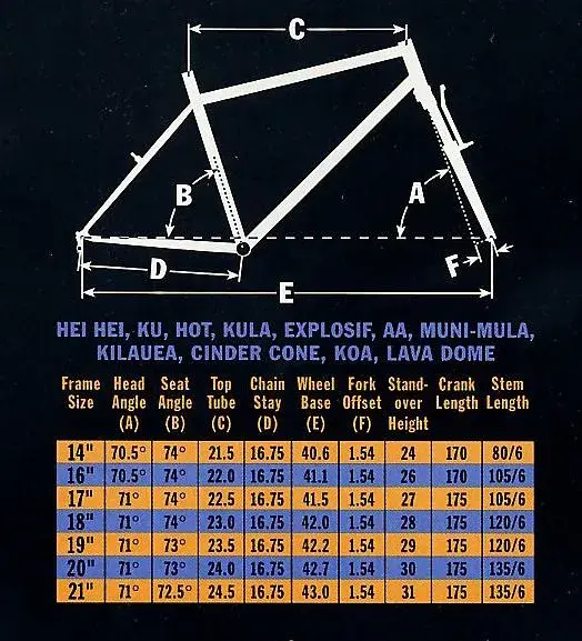

The geometry chart below shows how they used stem length as a major part of differentiating between sizes - in theory, you shouldn't because stem length should be all about steering characteristics, but it's evident that they used stem length and also seat tube angle to minimise wheelbase differentials. I think they're saying it's the lesser of two evils - i.e., a long stem deadens the handling, but a long wheelbase deadens it even more, so we'll go for longer stems and slack seat tube angles in the bigger sizes as well as longer top tubes.
The intended height range was roughly 5-0 to 5-6 for size 16, 5-3 to 5-9 for 17 and 5-6 to 6-0 for 18. So I guess you can look at the standard stem for each size and adjust according to your height. But it's only a reference point - in the end, it's all down to personal taste anyway.
