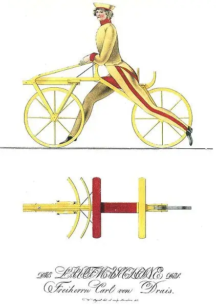

Just seeing the first pic reminds me of the 2nd :lol:

Thats too retro for me ;-)

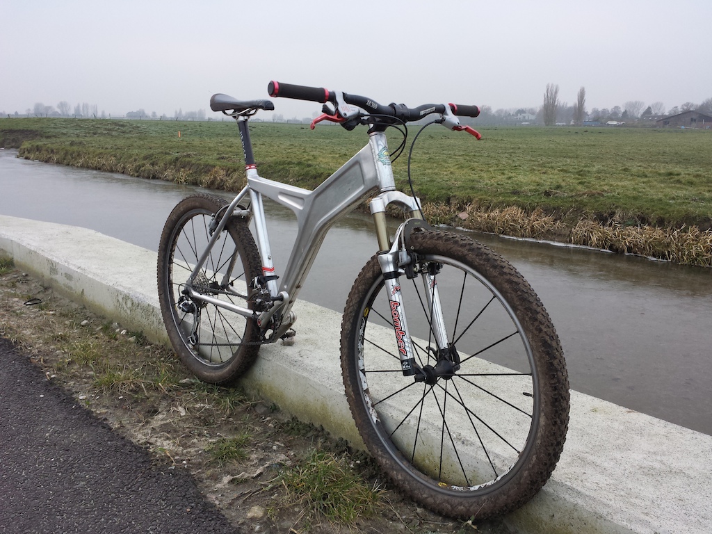

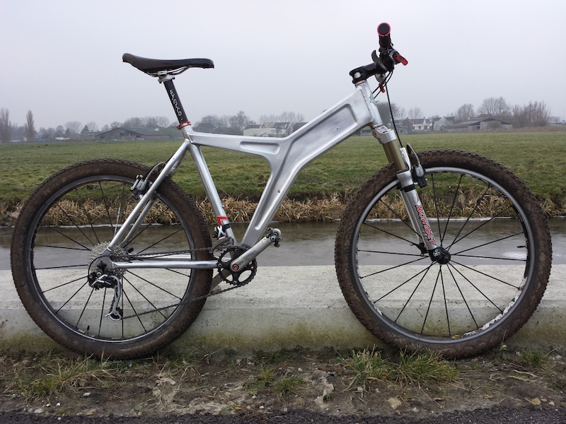

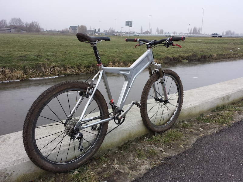

Checked the weight: in it's current 1x9 state it's 11,5kg, pretty OK for such a bulky frame.
And of course some updated images:
Now I just have to find a proper chainguide instead of this old XTR front derailleur. Tried it without a guide but speeding over roots and drops dropped the chain...
That thing is just cool. Have you thought about a narrow/wide chainring instead of a chain guide? I have a Race Face one on my hardtail and it's been fantastic.
I had a 30t Hope narrow wide on it before (which worked like a charm) but that had to go to my new Krampus. So for now I fitted something I had lying around.
And nice to see you guys think it's cool! On of my buddies (riding a Cannondale Trigger...) thought the Monocoque was a Halfords bike. (In the Netherlands Halfords is pretty crappy, they don't sell Voodoo like in the UK)
I guess a Paul would be more period correct, but the Superstar jobbies have so much colour choice 8) . . . or you could go down the DIY route as I have with several builds (DMR hinged clamp, Blackspire/MRP or DMR roller and appropriate length allen bolt and spacers to fine tune the chainline).
Although as suggested above, if you're not too worried about fitting more modern stuff, a narrow wide chainring would be perfect. Not tried the cheaper Superstar chainrings but both Raceface and eThirteen rings do the job just fine.
