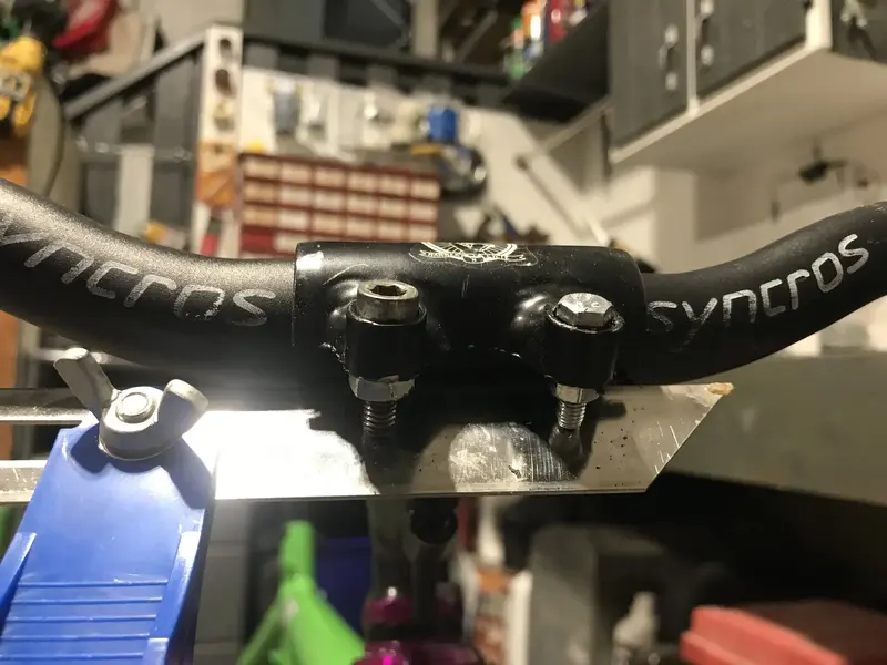

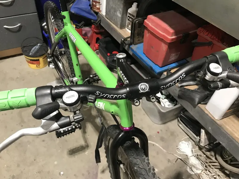

I feel like it will be impossible to open it enough but I will definitely try this, thanks so much for advice.There is a trick how to get a riser bar into a syncros stem. Put a coin or something metal inside and put the screws in on the downside of the stem, than you clamp the stem a bit open (because of the screw is pushing against the spacers or coin. Et voila it fits!
