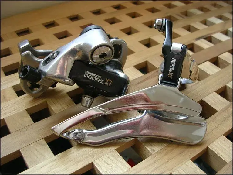

Any idea what model numbers I'm looking for XT Front and Rear Mech and do they come up on here often?
Seen loads of mechs for sale but no idea what ones I need:-(
