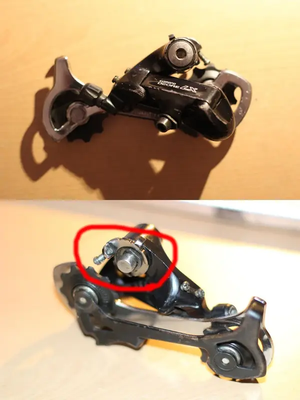

Deore LX rear mech, it came with the spring on wrong? However, I've no idea how to put in on right. Any tricks??

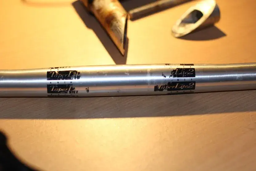

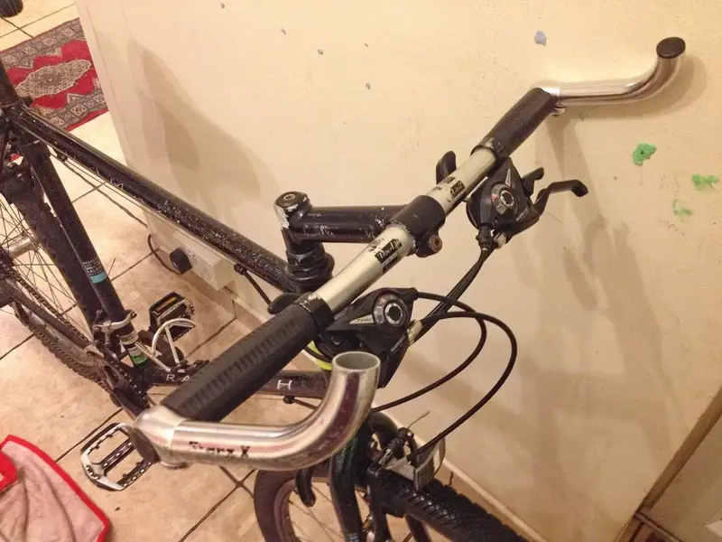

Answer Taperlite 2 handlebar, really tidy except rubbed off logos. Soooo light compare to what I'm used to. Will test it out and see if like straight bars.

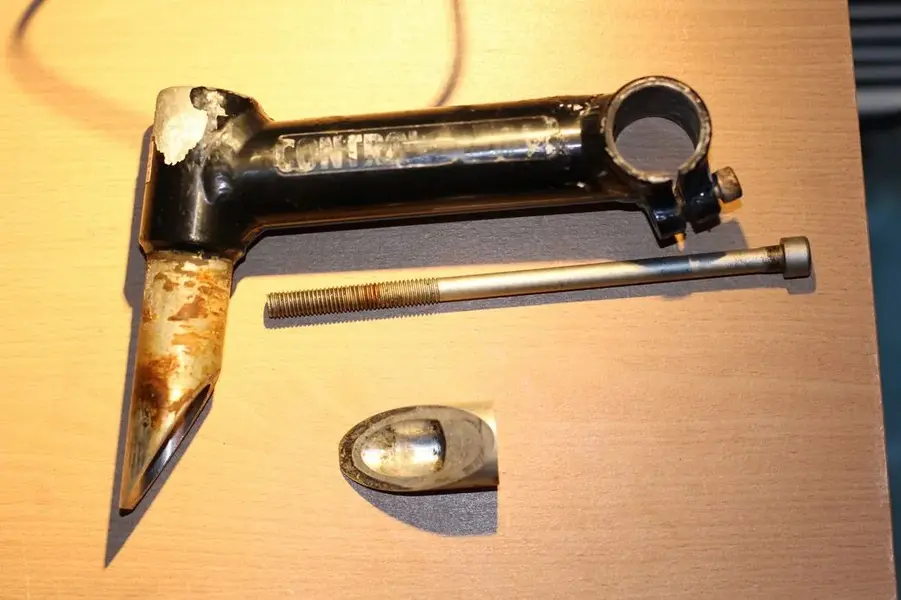

Control Stem, very tatty and needs a clean but looks don't bother me too much. Has definitely been left outside for a while, I saved it from a scrap pile together with the bars. It's missing the top cap but again, lighter than what I've got now!

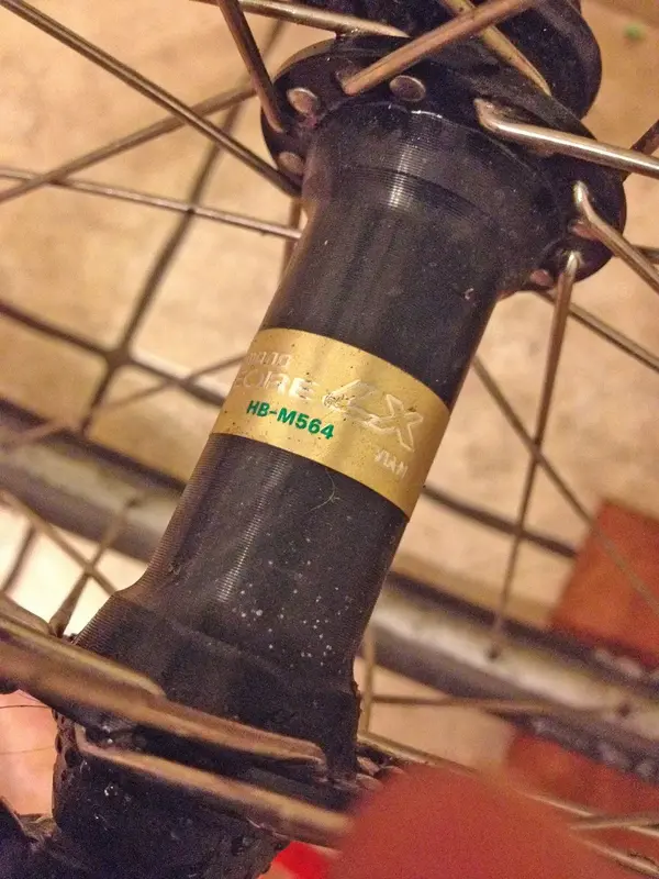

I will post an update tomorrow of the whole bike as a lot changed since the last time I showed you. Currently, it's spotting Shimano 'A' rear mech, Deore LX front mech and a front wheel with Deore LX Parallax hub and a Mavic rim.

The circlip on the bolt removes like this:
And you can then spin the washer-bit round 180 degrees and replace the circlip.

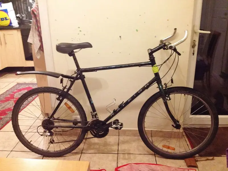

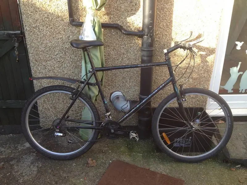

Right, photos taken with my phone so not the best but will give you an idea. The bike is filthy as it's used everyday in any weather. I'm a brave boy :mrgreen:
Updates since the first post are:
-Front wheel: Deore LX Parallax 100 hub laced onto a Mavic 238 rim with stainless spokes.
-Control stem + Answer Taperlite2 handle bar with Tranz X horns (saved 530grams over the previous set up!!!) Pretty sure this came off a Marin.

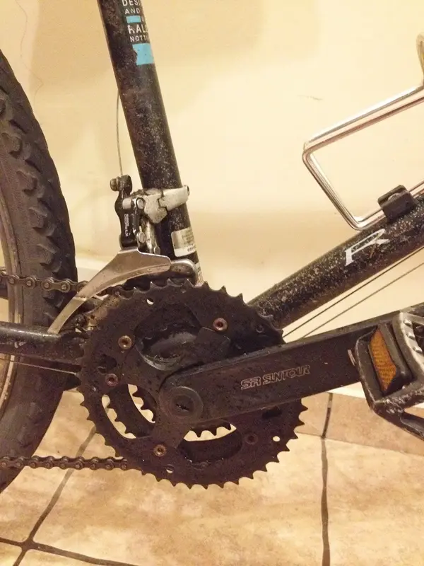

-Sr Suntour cranks (chain rings are a little bigger than the previous as I was running out of gears) Came off a modenr-ish Diamondback.
-Shimano Deore LX front mech.
-Shimano 'A' rear mech.
-Period correct Raleigh Grips (actually pretty nice!)
I will give this stem a go as it's just over a 1cm longer and straight bars replaced a slight curve, might be too much of a stretch! It's amazing how much of a difference better spec gears make, so much snappier.
Plan is to do a conversion to 8 speed, now running 7 speed cassette with a spacer so just need an 8 speed cassette. With that I would like some more period correct shifters and brake levels, perhaps Deore thumbies? Pedals are terrible and slippy. Added mudguard and a bottle cage for usability, looking for a front guard too as today my shoes got splashed like hell!

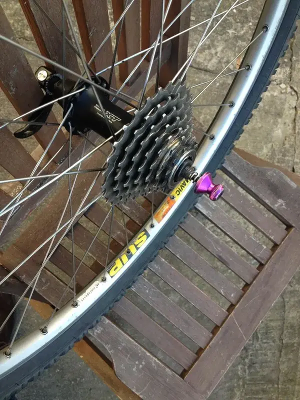

Built my very first wheel! Shimano Deore XT hub, DT spokes and Mavic 117. it's nice and straight but i think it needs more tension, I did a test ride and it was all good but I will get someone more experienced to have a look.
The bike currently sits on a older type Deore LX and a Mavic rim on the front and the wheel I just built at the rear.
