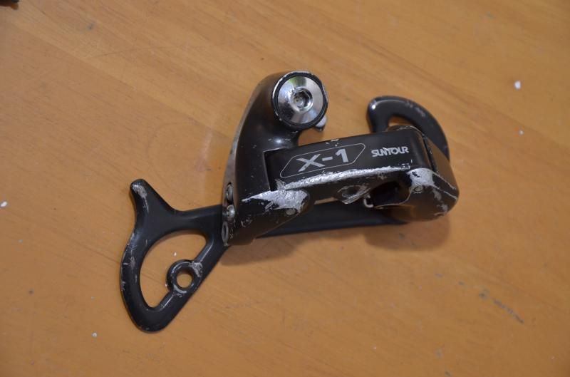

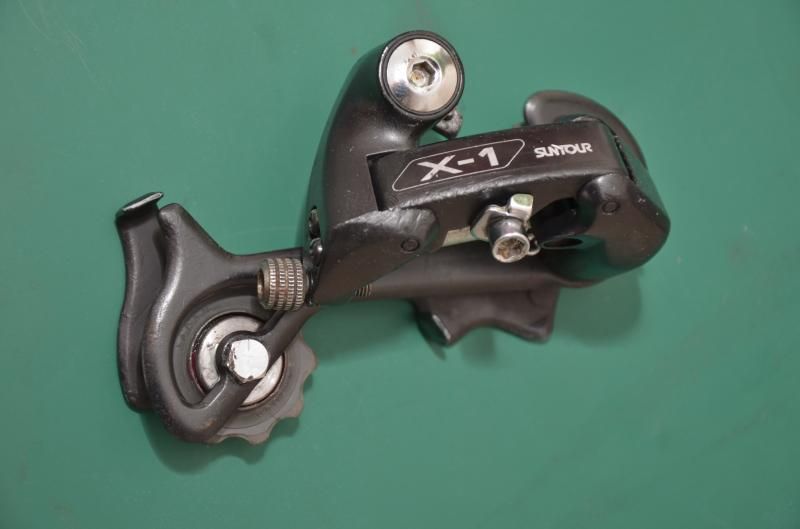

Got the rear mech cleaned up and sorted out.
Stripped and cleaned

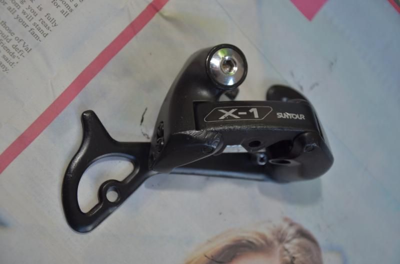

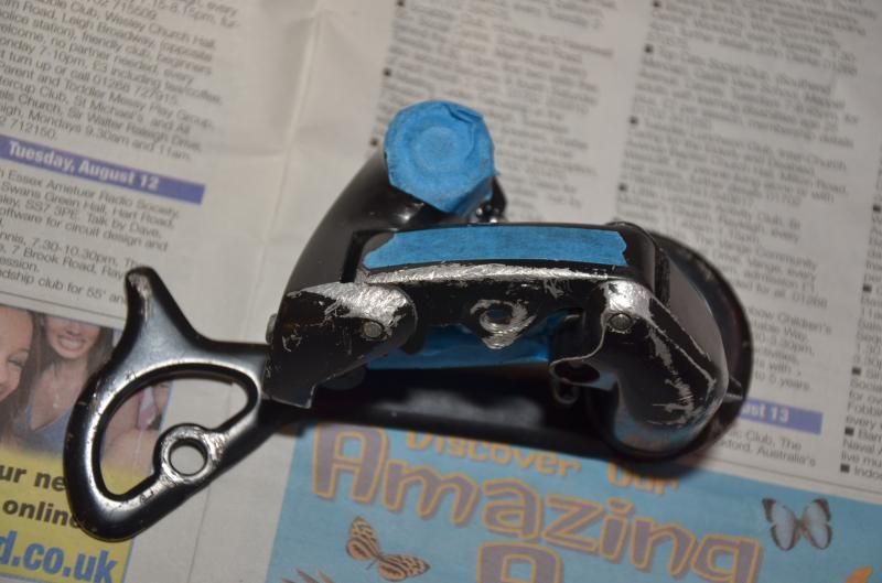

Masked up....
Painted......with Acid Etch primer and black stove paint
Re-assembled.....and ready for re-fitting

SIMONFREESE":14cv7oyg said:
I won't recognise this when it's finished! Looking good Mart :)
I've done a bit more to this than I had originally planned - but I think it's worth it. I agree - it's going to be unrecognisable to the bike that I bought last July.
Looking forward to seeing your Raleigh project emerge!
Dare":14cv7oyg said:
Buy yourself set of diamond files to flaten thise scratches on RD.
Yeah - I had the same thoughts just after I'd sprayed the black coat. I've got a set of needle files which I've used to good effect on an XT RD in the past. Didn't even cross my mind to do it on this one! Maybe I'll sort it after everything else is finished..... :)

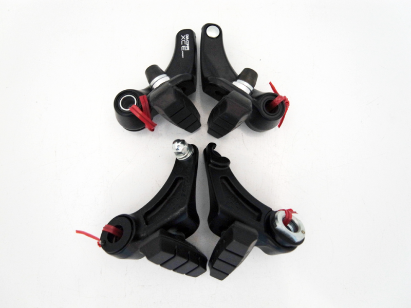

Started fitting up the brakes to the Tequesta this evening and stumbled across an issue with the front brakes....and as with most of the bits that I've taken off and sorted it's been bodged.
When tightening up the fixing bolt for the RH cantilever arm there seems to be loads and loads of fore/aft movement - i.e. the arm can slide forwards and backwards along the canti boss!
After a quick google search it seems the RHS canti brake is missing a part - which allows spring tension adjustment (the silver boss with the flats on it - bottom right image - image from t'internet)
Bollox. Chances of getting a replacement set of these brakes?? Would like to keep it original if possible.....
I can fit these up and space the canti arm using a couple of washers (how the original owner had bodged it) but it means I can't then adjust the spring tension to centre the arms.

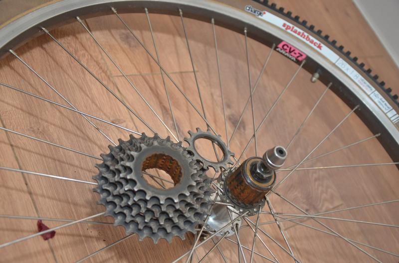

After sorting out a NOS replacement suntour cassette via the retrobike for-sale page I bought another chain-whip to attempt removing the lock-ring/first cog on my missing-a-tooth cassette.
First attempt.....no sweat. Job jobbed....happy days. :)

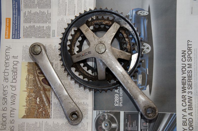

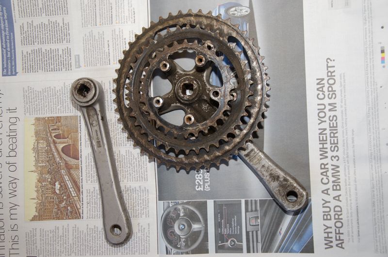

Turning my attention to the cranks & pedals.....

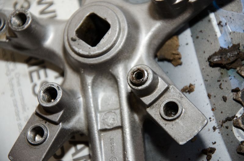

More bodgery. Middle ring fitted the wrong way round! Also a sheared bolt/slightly bent granny ring
Stripped down and cleaned up - intend to repaint and re-use. Bolt has wound out really easily which is good.
