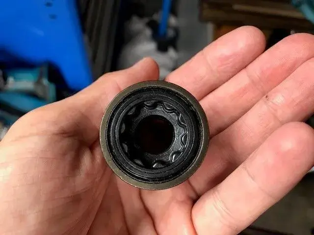

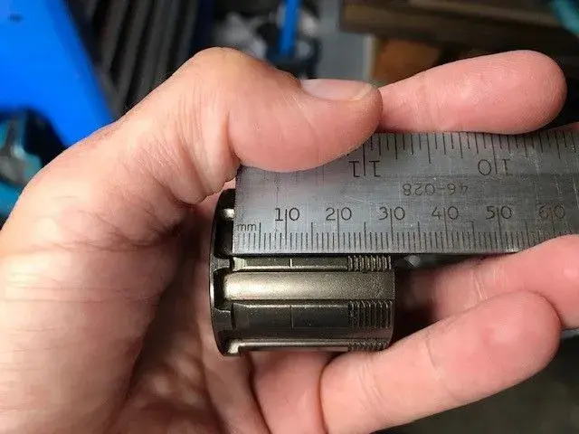

Regards the Freehub, there are 2 x things to address.
1. The shorter freehub currently on the bike won't take 8 speed (or might do with a bit of playing with spacers / cogs).
2. The longer freehub (which would take 8 speed) doe not work with the way the freehub is attached to the axle.
At this stage I am more bothered about item 2 - making sure I buy the right one. Once procured, I can sort out the cassette spacings etc.
Where? I blew the pic up and couldn't see that. It is 7 speed.

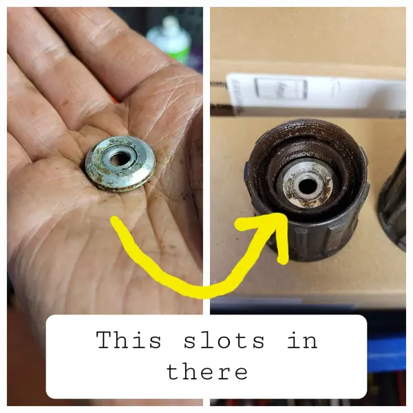

yer, that isn't standard, I think the outboard bearing has been removed.
