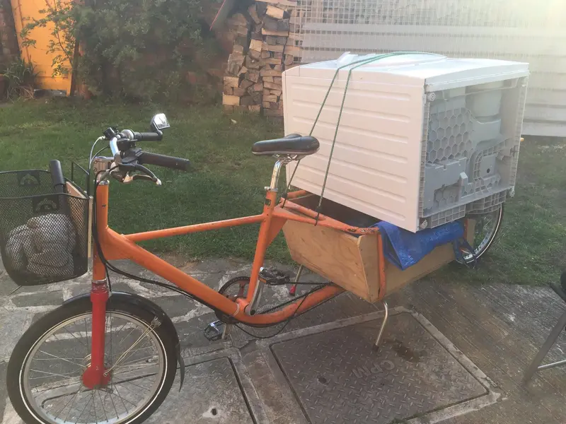

25/11/22 Continued.......
I also managed to get the cranks off (a non-matching crankset), the BB removed (then re-fitted temporarily) and the chain removed.
Cleaned a little bit and inspected the frame etc.
View attachment 682953View attachment 682950View attachment 682951View attachment 682952View attachment 682954View attachment 682955View attachment 682956View attachment 682957
It's had some repairs and it's had a few "fixes" which I will look to improve upon.
The bike had clearly lived a hard life, and it's quite the project. But providing I can get the parts I need it should be ok.
I'll order the wheel bearings this week (3 x different sizes) and try to find some replacement brake shoes.

When I got mine it had similar wear to yours where the chain goes near the bars. if the chain jumps off one of the guide jockey wheels it will grind until you realise. I have snapped on pieces of plastic conduit over the bad bits, more to prevent it happening again than to hide the damage. I have a little cage around the pulleys so that the chain can't really jump out, this seems to have been an original part but was bent out of shape when I got it.
