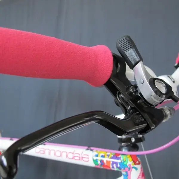

I'd been looking for some pink Grab On's for ages but I then read somewhere that they only made them in black :facepalm: , so I widened my eBay search and found the Johar Rad's. Are they that rare? I got the impression that they might be.
This whole build has been a tour de force in difficult/unique parts to find, which I hadn’t anticipated when I started. The plastic A113 cable guides came from Australia and I was told they could be the last NOS ones left as the factory who made them was burnt to the ground, the front mech seems to be a special that wasn't listed in any Suntour literature and the brake/shifter levers only seem to exist in a grainy photo.

Brake/shift levers: Suntour XC-9000 (CL-XC00). CB-6200 brake lever with LD-5100 “Power Control” shifter and custom made stud and mounting plate made by Intrincycle

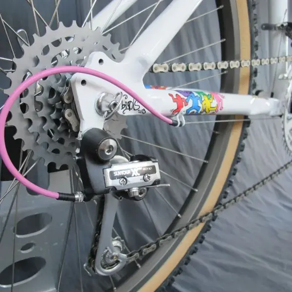

Rear derailleur: Suntour XC-9000 (RD-XC-00)

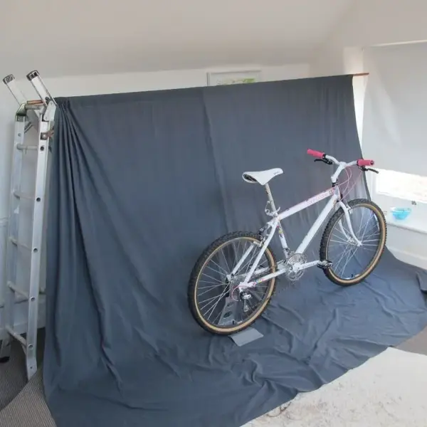

I was really struggling for time to get the full shot uploaded before I went on holiday; thanks for the positive comments.

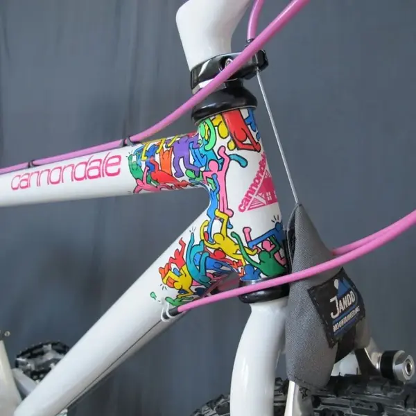

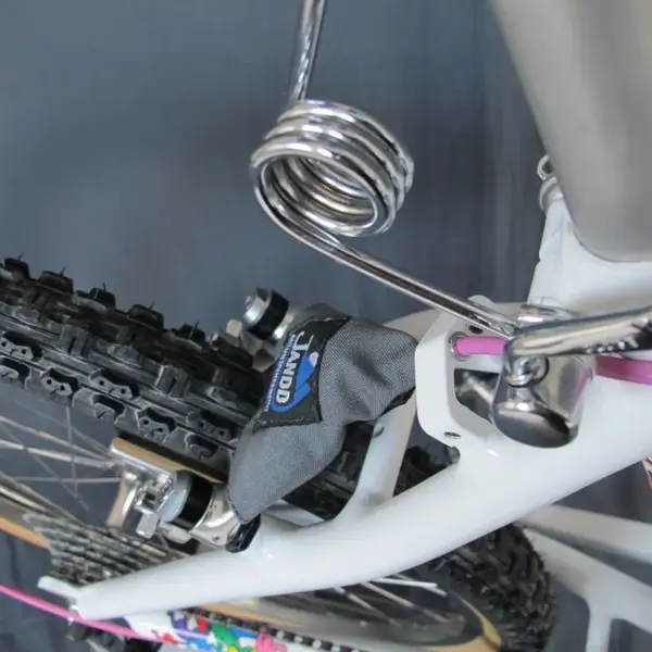

I set up the "studio" again this afternoon to take some new shots plus I also wanted to show off my NOS roller cam brake boots which were sitting on my door mat when I got home; cool aren't they?
Anyway, I'm planning on going taking her for a test ride over the weekend so I'll give you an update on how I get on going back to non-index shifting! Studio....webp
