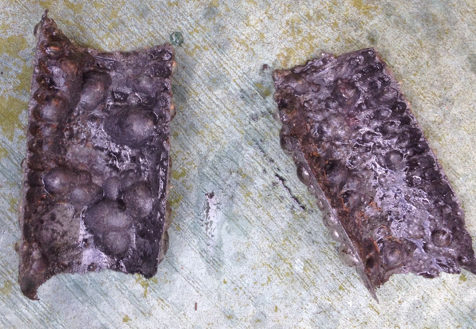

Well. That was epic. Most rewarding. To see the frame bucking and rocking on the stand as plumes of steam billowed from the bb while the post hissed and screamed in desperation. Two hours and it was over. Two hundred and twenty millimetres of post vanished into the ether. Alchemy. I mixed my potion as strong as I dared. So strong that I could barely hold the water bottle I used to dispense each dose into the neck of the seat tube at the bottom bracket. The heat generated in the bottle was of little consequence when compared to wrath of Hades Suffered by the painted frame.
The final death throws of my nemesis consisted of a fizzing, bubbling sliver of silver. Rather reminiscent of the terminator 2 denouement.
The foe is vanquished!
Sat having my tea with this on the table in front of me. I was going to hand paint or spray this myself but looking at the 'patina' I actually quite like the battle scars and records of adventures past. The paint was in such poor condition before today's ordeal that the new injuries seem to add to the character of the frame, rather than detract from the overall look. I've done a bit of rust stabilisation after drying it out, spraying in the tubes with wd40 before a rest in a sun bathed tree for the afternoon.
