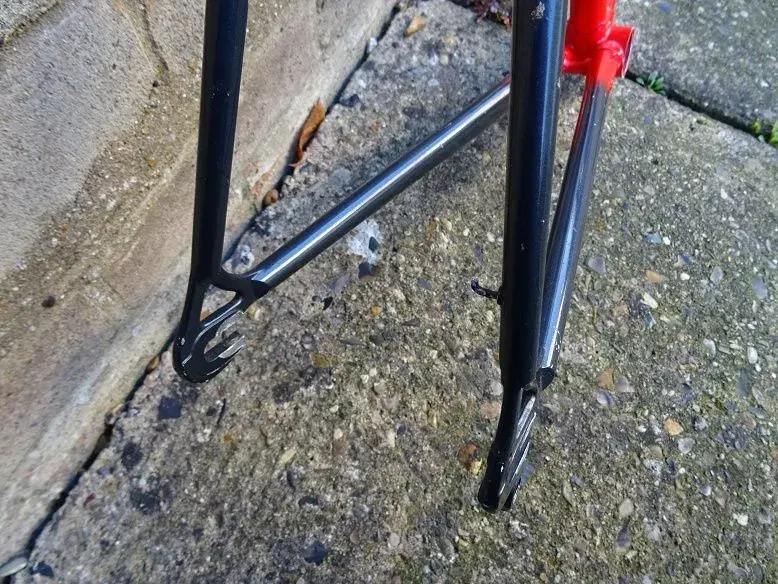

......in the interests of assuaging curiosity and providing a modicum of pleasure in this yuletide season, here's the frameset in all its glory :xmas-big-grin:
......even the chain hanger seems to be a lightweight variety!.
Matt
