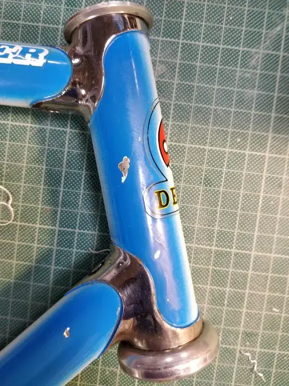

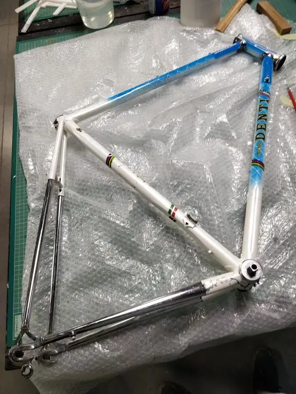

The frame is in generally pretty good condition, fork excellent with minor rust spots and grime under the crown. The paint scheme is dead 80s with a lovely pearl white base and fishnet-masked blue fade over the top. The major issues that needed sorting were the paint loss around the bottom bracket, and seat cluster, general paint chips and some rust spots on the chrome lugs. Some of the decals are original as far as I can tell, but the larger down tube and seat tube decals are definitely repros as they have been fitted over some of the paint chips! :rolleyes: I considered leaving the paint as is but it was just too ugly to put up with. Sorry to the original paint purists amongst us. ;)
I have a full decal set, including the correct Columbus tubing stickers (my research leads me to believe that these frames used Columbus SL badged up 'Denti').

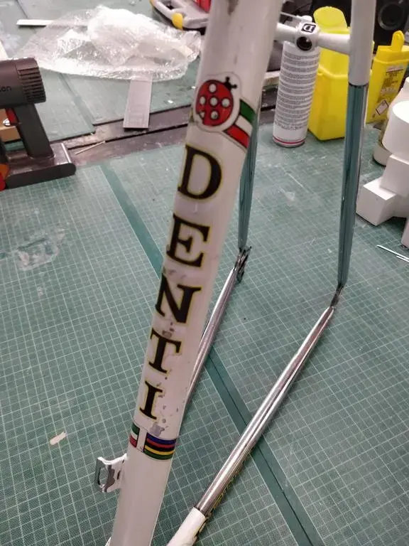

First job was to remove those decals that needed replacing. It was pretty time consuming as they were old and gummy, coming off in shreds rather than neatly peeling.
I left the head tube logo and the 'MASTER' text as my replacements didn't quite match the font and these were in good condition.

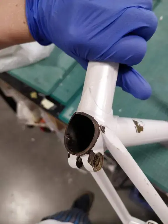

Then onto planning what to do with the paint damage.

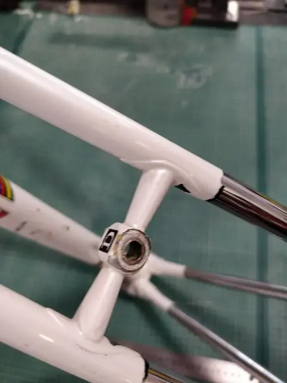

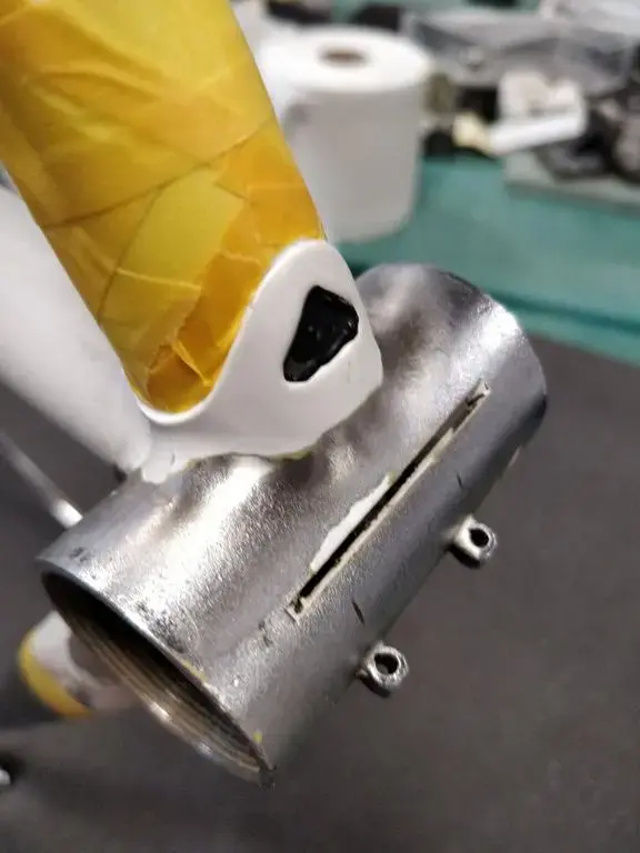

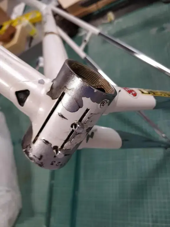

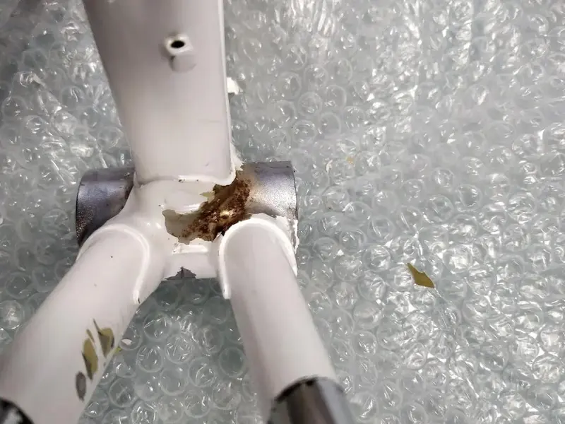

After investigating the BB area further I found the paint in quite poor condition, flaking away from the bottom bracket casting with the touch of a fingertip. The main issue is the chroming includes the BB which has been keyed but clearly the paint adhesion was very poor from the factory. Some surface rust on the chrome was also hiding under the worst affected areas of the paint
Yuck!😣

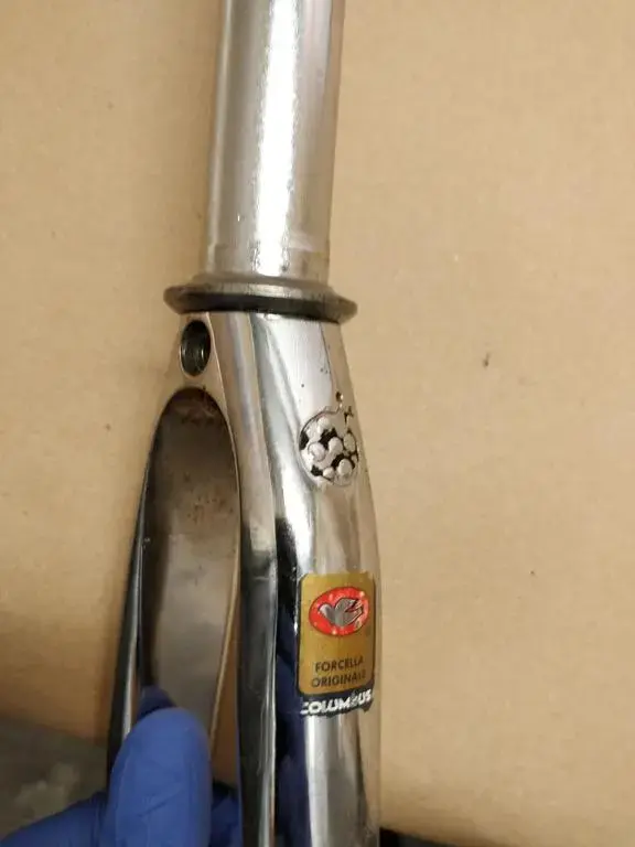

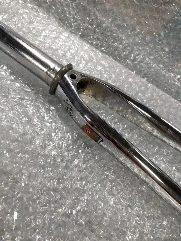

To start with I cleaned up the fork, removing the old paint and damaged tubing decals.

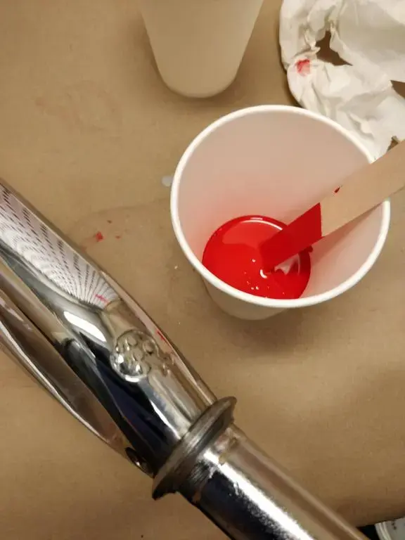

They are finished with a quick paint fill on the little panto ladybirds - Denti's family crest I believe.

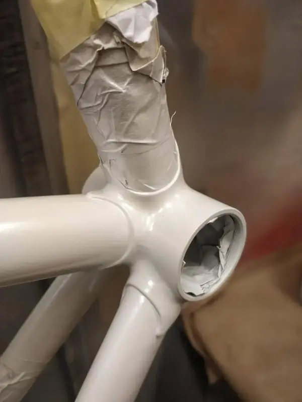

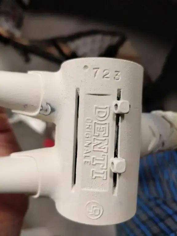

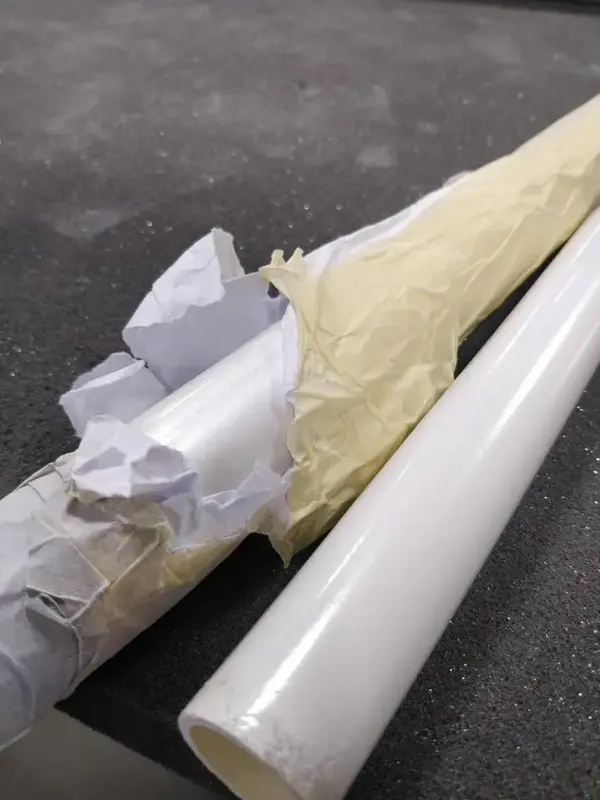

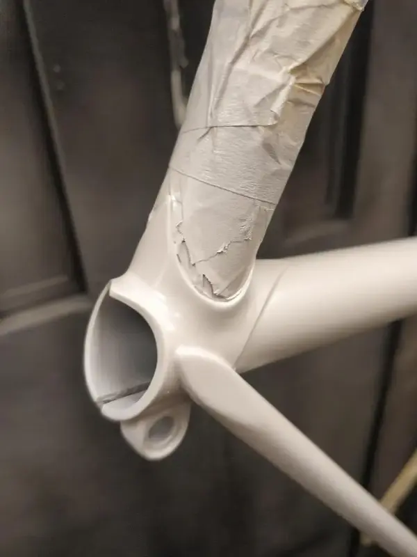

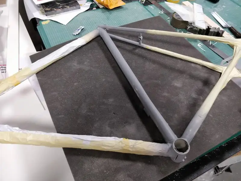

I decided to take a slightly unorthodox approach to this, with the front half of the frame paint being reasonably good, along with the blue fishnet fade being a challenge to replicate, the answer seemed to be to only paint the rear triangle/seat tube. I masked off up the BB and seat cluster lugs. I also masked the chrome at this stage. Next, after removing all the rust and tidying inside the frame, I used 3M sanding pads to smooth out the remaining paint around the damaged areas and keyed the rest of the surfaces
I then applied an etch primer and a couple of coats of filler primer, sanding between each stage to level and smooth the surface.
Next will be the white base coat, then a pearl to match the original, followed by a final lacquer coat or two.

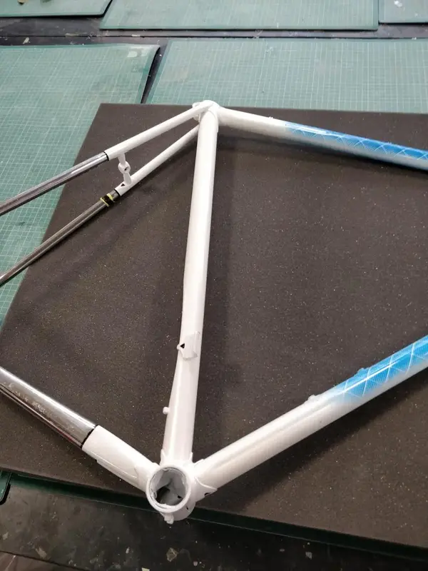

I sprayed up a couple of samples, then after getting the primer layers flat, sprayed the white base on the frame then a pearl coat over the top (Specialist Paints Pearl Silver; https://www.specialistpaints.com/products/pearl-paint?variant=14245216903).
Checking the sample...
Then go!

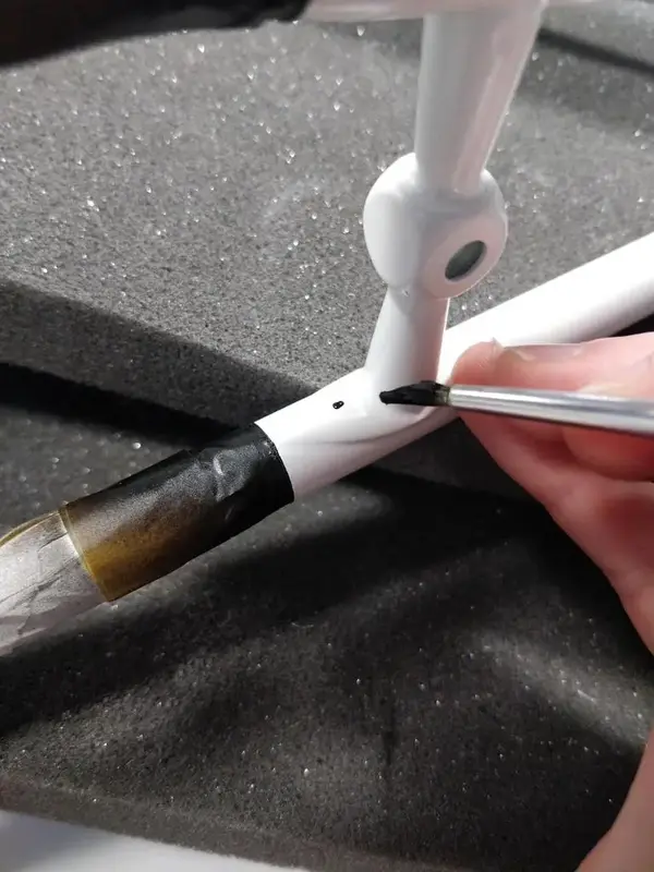

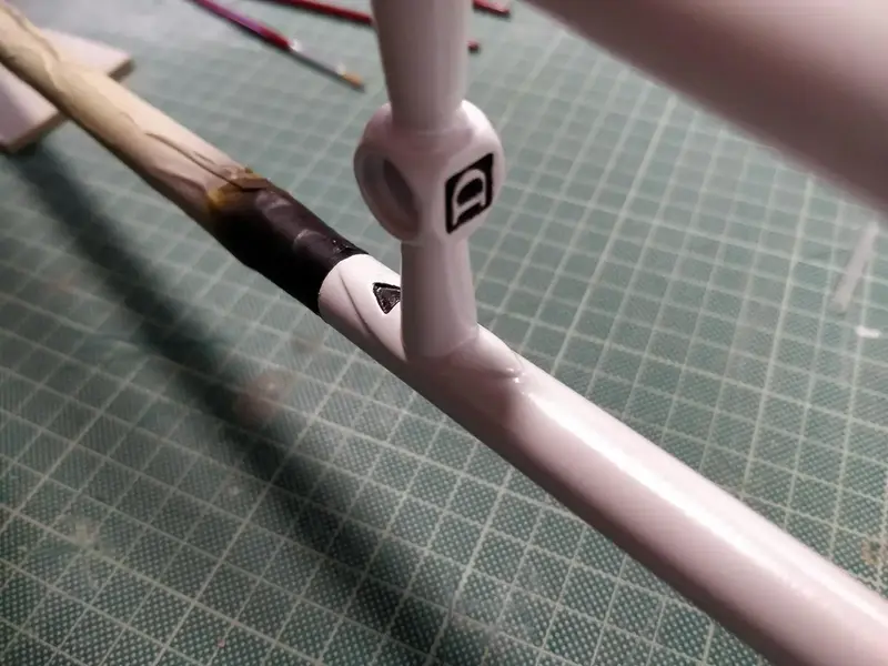

Very happy with the finish match. Next was demasking then hand painting in the little bits of lug detailing and panto paint fills in black.
Next up is touching in any scrapes in the blue and polishing up the chrome. ☺️

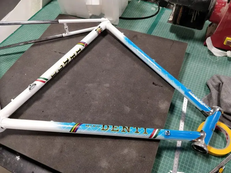

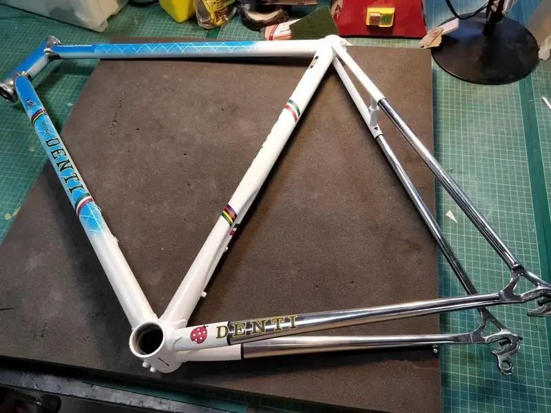

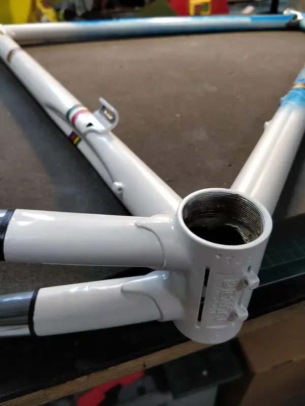

Hi all, just starting the build on this and realised I'd never shown the finished frame. See below!
This is the paint finished barring a quick whip round with a scalpel.

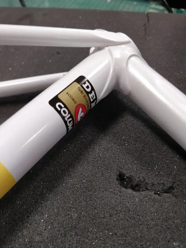

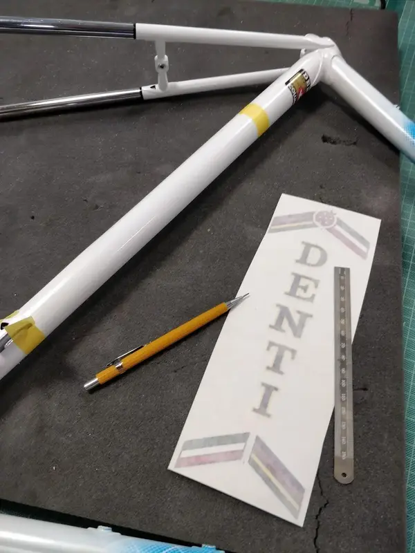

Next the decals had to go back on;
Lots of painstaking work getting it to this stage but I am very happy with it given the state the paint was in.
BB detail;
