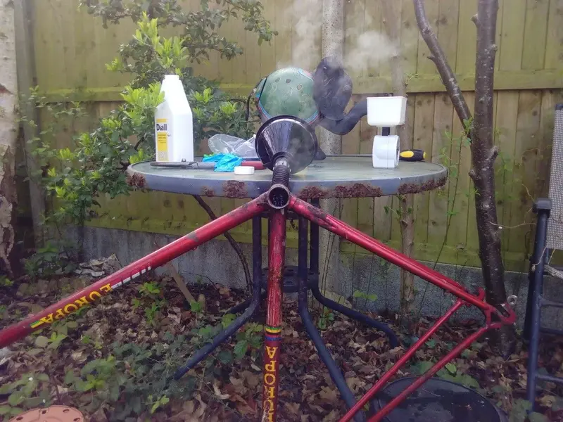

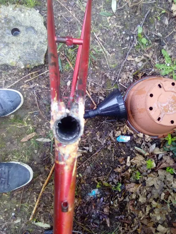

7th) It will gas, smoke, bubble and gurgle all the time it is acting and working, so once it isn't doing it so much then that means there's not a lot of aluminium left.
8th) After about the 3rd jugful I thought I'd see how it was doing and twisted the top of the seat post off which left a very thin seat post remnant inside the seat tube, this still wouldn't come out even though it was no more than about half a mill in wall thickness and I tried to peel it down the inside of the seat tube using a mallet and big flat screwdriver.

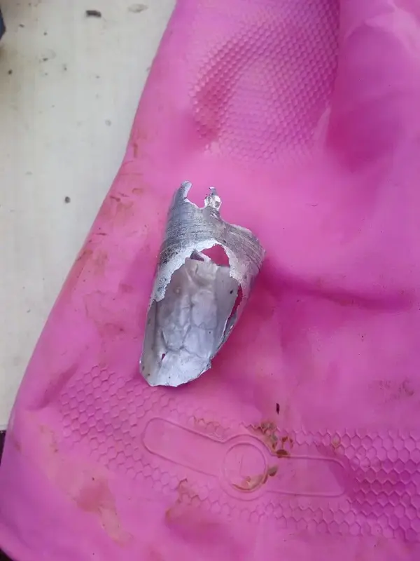

9th) after the 6th jug full what I was finally left with was a small bit of tin foil that finally came out.
So success, it took a while, made a big fuss about it and made a big mess but ultimately it worked and I'd happily do it again if I needed to.
And lastly, remember safety first, its nasty stuff and only use this method on aluminium set posts that are stuck in steel frames, anything else will go very badly wrong.

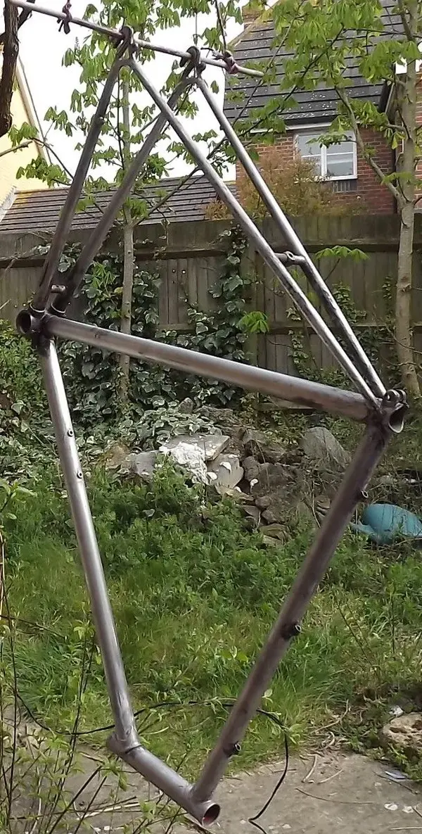

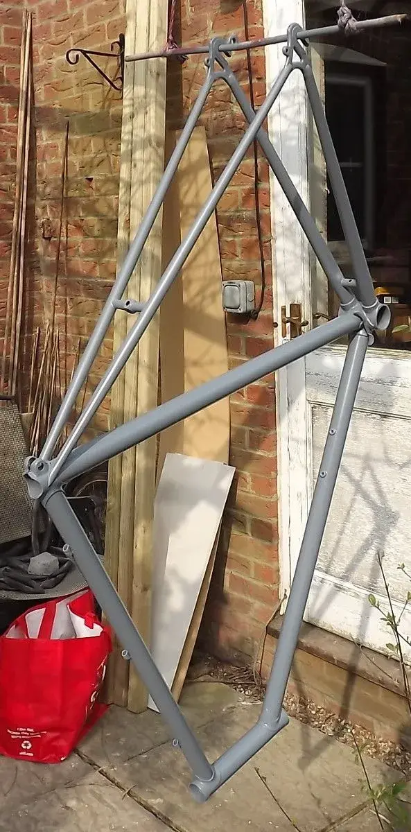

A little bit more progress on this.
Greg in Australia contacted about new decals. Frame stripped of paint and treated for rust, It was nowhere near as bad as I thought it would be corrosion wise so needed surprisingly little treatment. And first coat of primer on.
I'm hoping to get it rubbed down and another coat of primer applied, 2 coats of base coat silver and with a bit of weather related luck the cherry red lacquer on over the next week or so then it will probably stop for a while as I clean all the various bits, get replacements for the odd bits I'm missing and wait for the decals to come from Australia.

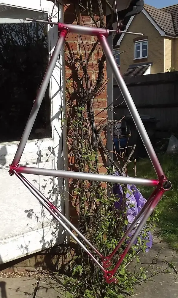

Another couple of steps further on. A couple of coats of silver base coat and the lugs and awkward bits with a coat of red lacquer on.

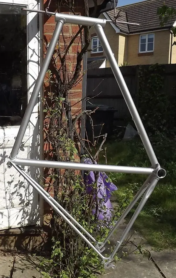

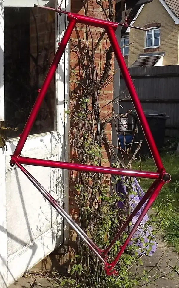

Bugger!!!
I knew I should have gone for blue, I've got a few cans of that. Oh well I'll leave it hanging and wait for the post man to bring me some more red lacquer and as the suns out I'll get on with something else today.
