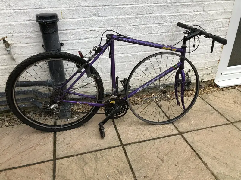

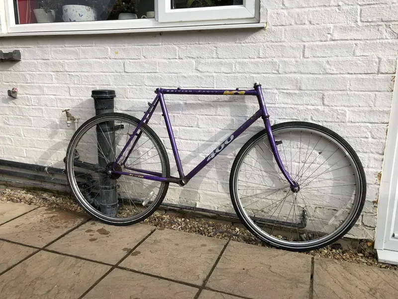

Anyone got any experience of this sort of conversion? I’ve just picked up what I think might be an ideal candidate..
531 Reynolds British Eagle in ‘dad size’ 22”..
Plenty of clearance with these 700c’s I’ve got - only hurdle will be brake posts but there are adapters for that.. anything else to consider?
Cheers. 👍
I put 700c with fairly chunky 35mm tyres on an Orange Gringo - fairly twirls along.
Obviously you have to sort out some brakes :)
Or you could use the rear bridge for the stays and the hole in the fork for callipers. Unless you really want v/canti/whatever the hell else brake.
better with discs and the biggest irony is that modern 26 inch tires tend to have a rotational circumference similar to a 700c wheel & road tire <goes to lie down after such big words>
