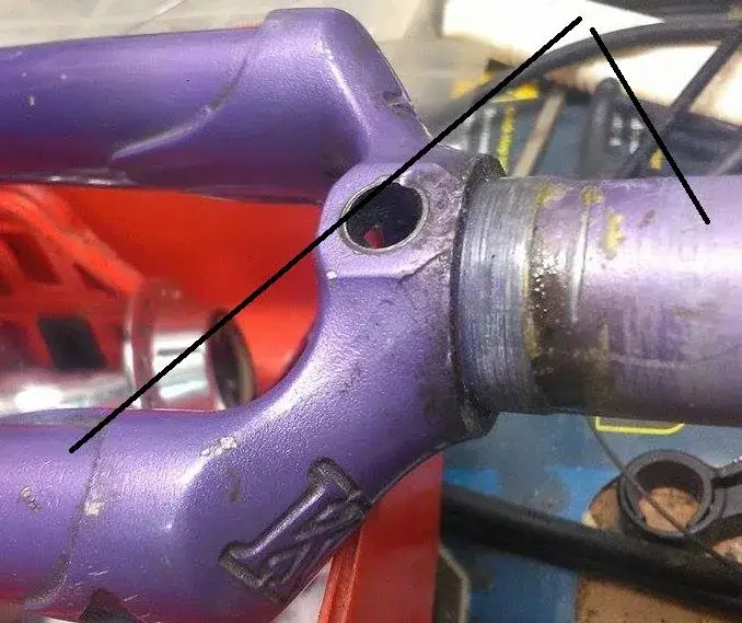

my Kenevans forks here have reynolds stamped on the steerer tube and 531 on the back of one fork leg

Hey, cheers latman, will look out for those once the frame's striped (living in hope :-) ) and good to know what to spot when I do come across a proper set of forks.
