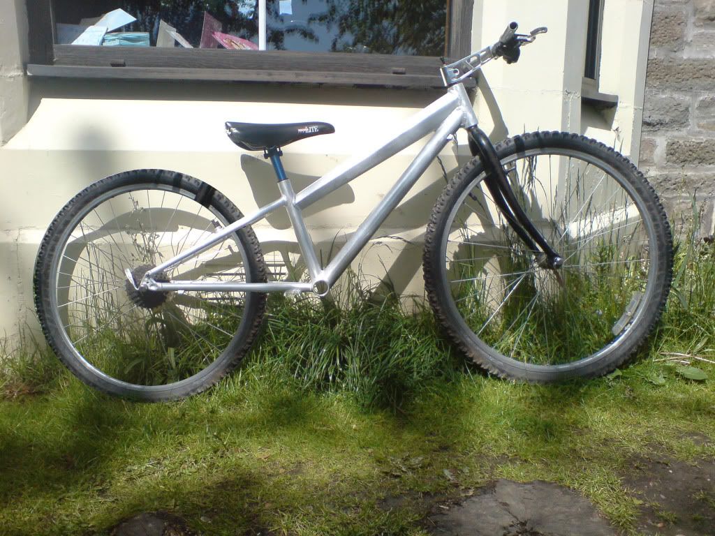

Just thought I'd start a thread for my son's new bike, it is a bit different and would be interested in hearing from anyone who has done this before.

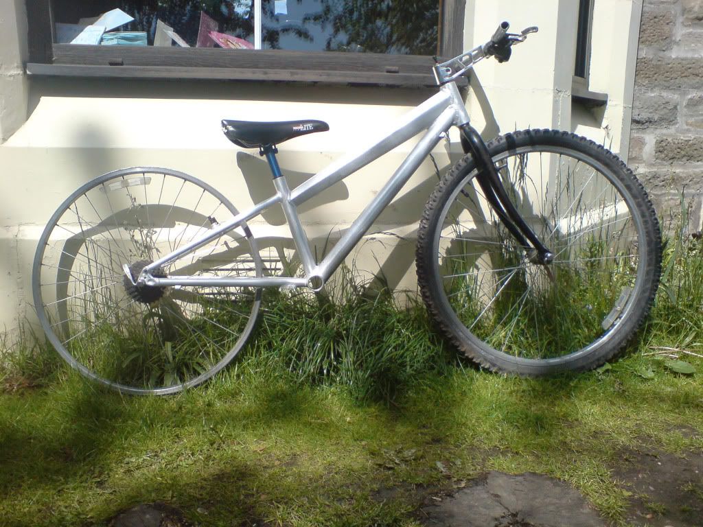

I'm making a 46er - 24inch rear with a 26inch front, it looks like it will work from my first mock up, but I'll need to get a rear wheel and fit the forks properly to be sure.
I spend sunday morning stripping the frame and with the intension of a respray, but it looks great naked.
Ive used a 26inch rim without the tyre to get an idea on how it will sit but the angles are looking ok.
I get the actual forks this week (orange F7s)
and will polish the frame and let miniKen Design the decals for it.
The frame is a 2005 Specialized Hotrock 24 and it is pretty light and very well made, the welds are lovely.
My intention is to build a bike that is as light as possible for a reasonable amount of money.

Perry is that a frame designed for 26 or 24inch wheels? as those forks look mighty long. At least I'm not doing anything too unusual. I was going for a trials/jump type look for him.
has removable v mounts for both
forks are 435mm axle/crown
you get less rotating weight so it accelerates quicker and a stronger wheel as its physically smaller . sometimes you get more mud clearance ( but not always , look at reanimations )
itl slacken all the angles unless you use a large volume tyre . 2.6 or 3.0 that makes the circumference similar to a 26" but weighs a lot and you lose all the benefits except a much smaller chance of bashing the rim
i had a mate who used a 24 on the front and a 26 rear with a big tyre , more cushion for the wrists but looked odd :LOL:
whats your plans for a rear brake ? would a u brake fit in there ?
looks alright , i like :D
Yeah have a look at my Last Rufus thread, 2 bikes wearing 24's in there.
I was chatting to a chap in bike shop, bit of a downhill nut. Made a lot of sense of running a fatter tyre on the back really as he suggests, but also have a look at MotoX bikes and stuff good enough for them this combo.
I never got on with my 24's but that was more to do with the package of the bike i think.
An inventive solution to a kids bike brief this. perhaps a 2.35 light tyre on the back might not be too much and thinner on front.
