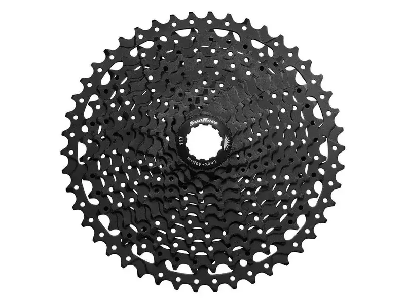

It's easier to just buy a sunrace cassette in my opinion
Kes
Exactly this ^^^.
I think before the major companies had brought out their wide range cassettes then an expander ring was a good (or the only) option. Nowadays you can get wide range cassettes relatively cheaply.
Well this was a tenner, so no harm trying it.
Which I did and no surprise but somethings very wrong and the cassette is loose. Seems taking off the 11t cog has made more room than is needed. And the cassette lockring is now too narrow and the cog it sits against is too wide so it doesnt tighten anything.
Bit confused on the other cogs youre talking about Jim. Its a sram pg990 9spd cassette which is one solid block and 2 loose rings - the bottom 2. Cannot remove any of the main cogs, and swop out the bottom 11t and its loose, remove the other and the spacing is wrong.
Sunrace you say :?
