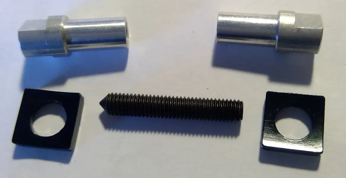

How about this?
Drill a 7mm hole through the downtube and screw together with plenty of threadlock. The radius inside the curved plates is not 34.9 mm diameter, but 38.1mm, so they would need re-making.
These are for aluminum frames and are commonly found on alot of older frames like Cannondale. The curved plate is also bonded to the tube with epoxy, or something. All things that can be done at home if you have a vice, a file, a drill and drill bits, and the bonding agents.
