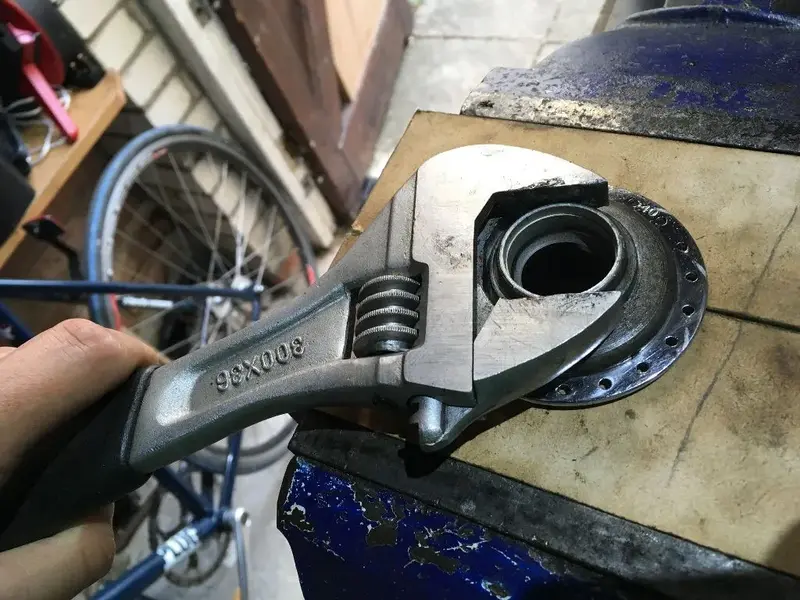

Does this mean that Peter has to put rims on to the hubs to get the end plate(s) off, or has he devised a special jig/tool that holds the hub shell?
I used to manage with a few loose spokes into an old rim for this, and to remove freewheels from hubs where spokes had been chopped out.

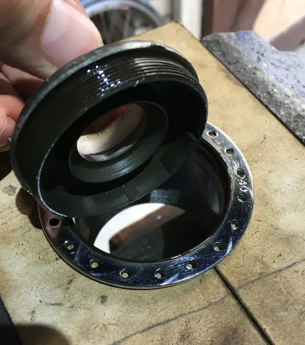

Having them laced into a wheel makes it slightly easier to remove the r.h. ball ring but if not I can usually remove them holding in one hand.
But yes, I do have a jig that can hold shells without damaging then. Had a few stubborn ones that required it but it's mostly used for removing l.h. ball cups on FM's and the like.

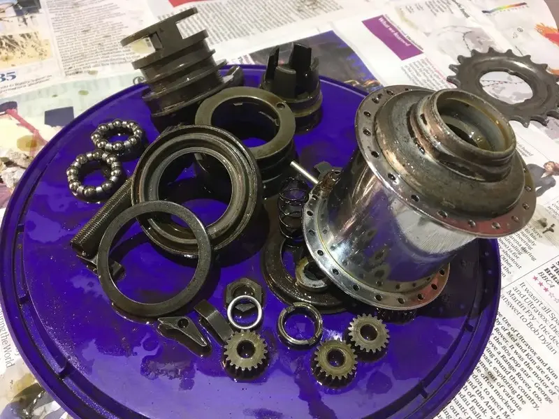

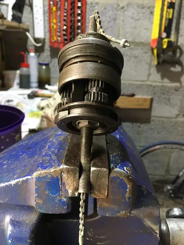

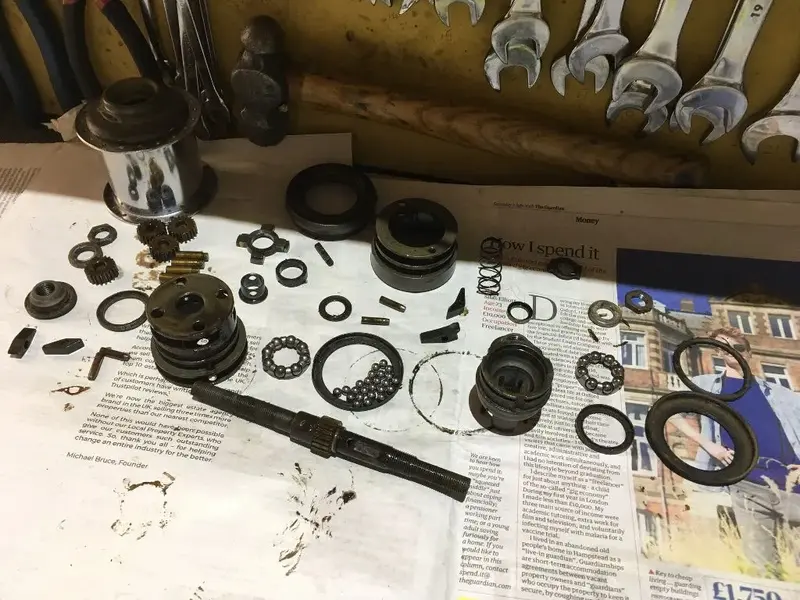

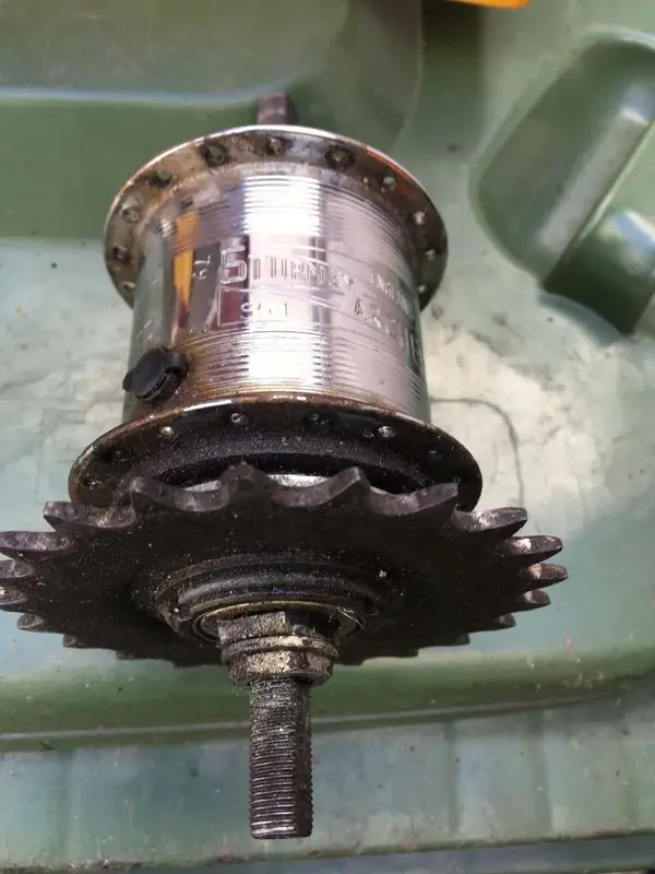

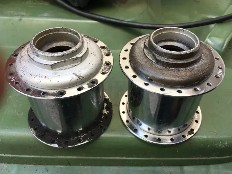

Just finished with the AW. Photos below.

:D Great stuff Peter, glad I spent the extra on posting the 61 unit now as a donor..... :D
Keep the photos and descriptions coming..... 8)

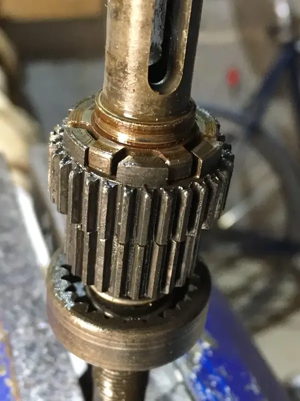

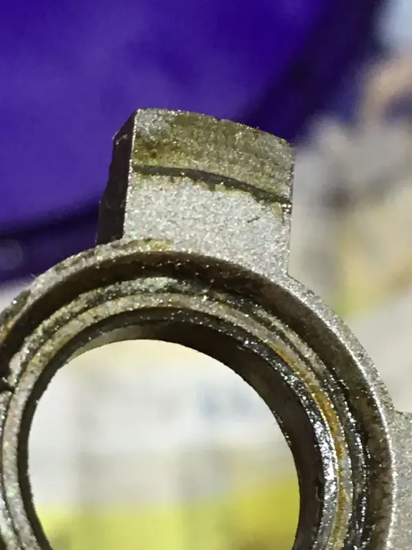

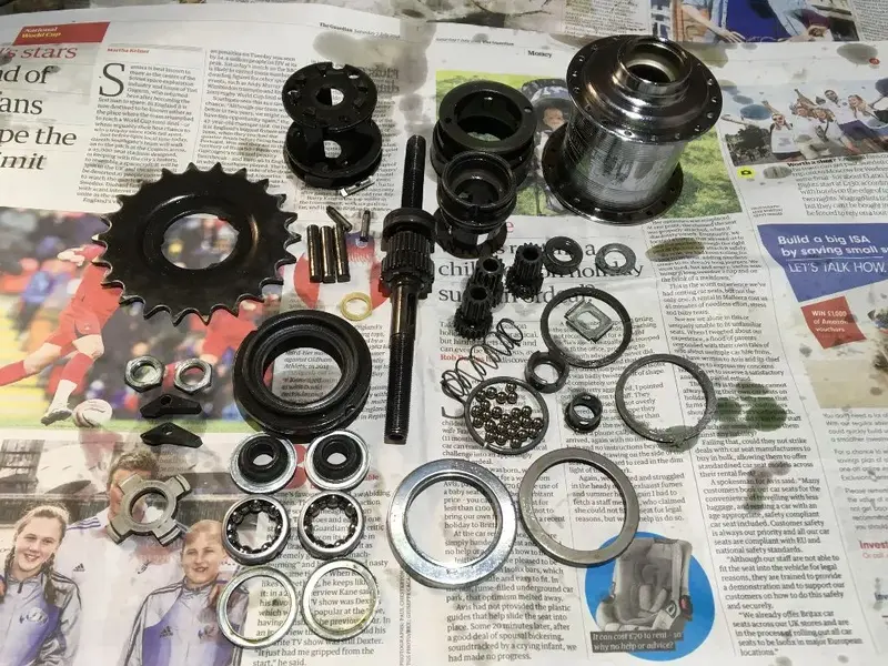

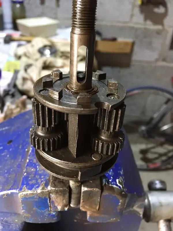

SA 1979 S5.1 five speed hub.
