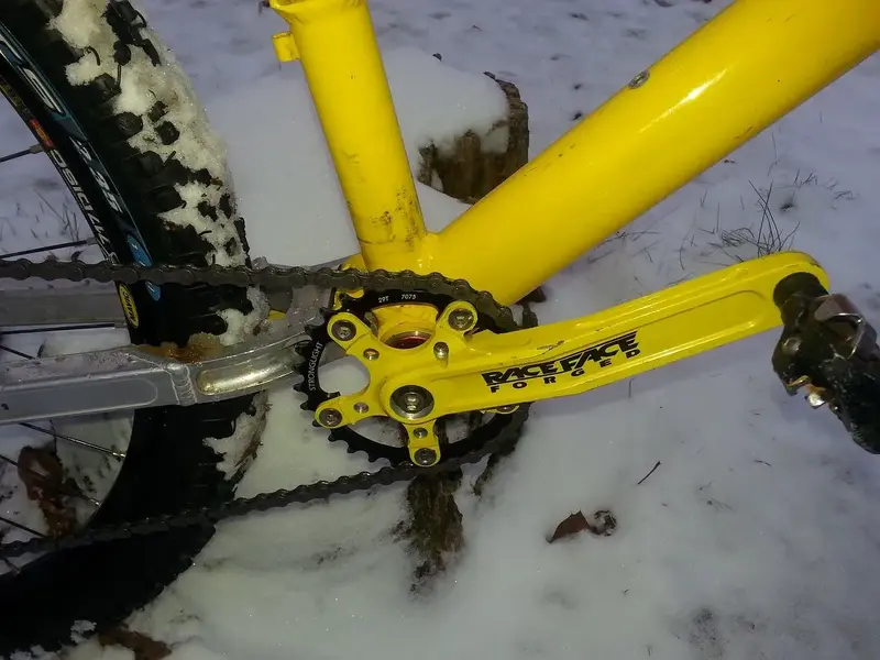

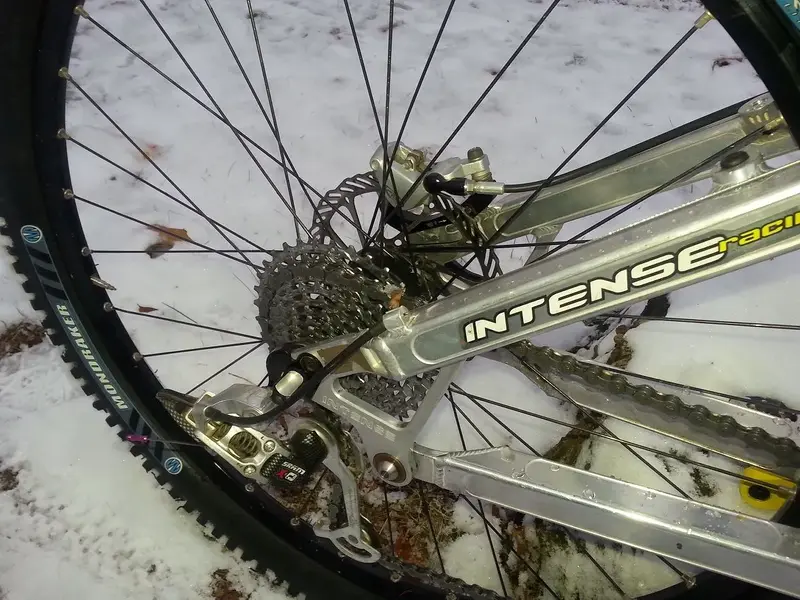

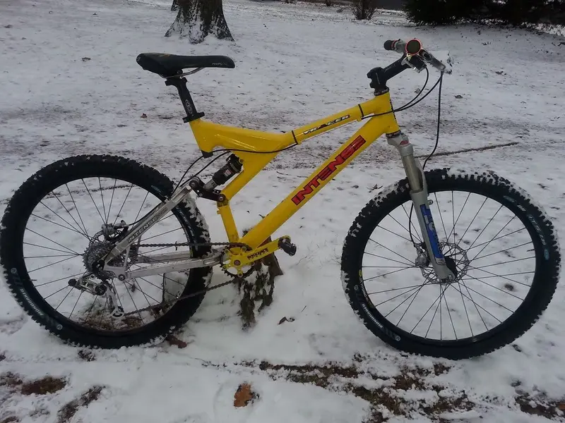

A 1x9 just built for my son.
I know not pre 97 but...
It shreds the Gnar :mrgreen:
