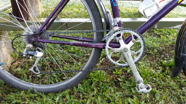

Only thing I would recommend if you do the 1X is a medium to short cage mech to help keep the chain on and shorten it as much as you can. This will help you keep the chain on without the need for a guide. You won't need as long of a chain without the big gear up front. This will greatly enhance the spring tension. The old long cages definitely will have you cursing on chain drops so ditch it if you go this route. Lot's of trial and error on this. Been doing 1X's off and on since the mid to late 90s.

After some googling, I've found that wolf tooth components make 110bcd 5 arm NW chainrings in 34t and up (in 2t increments). Race face also make NW rings for cross, but only 38t and up.
I currently use 24/38t chainrings, with a 12 (or 13?) to 28 8-speed cassette. I think my XT rear mech will go to a 32t sprocket, not the 28 as I thought. But even so, with only 8 sprockets it's impossible to keep the same range or very close to it. with a 32 sprocket, I'd need a 28t chainring to keep the same bottom gear (and they aren't available in 110bcd anyway).
If I decide to change, I think an 11-34 9 speed cassette with a 34t chainring is the best option. More or less the same top and bottom gears as what I have now...
